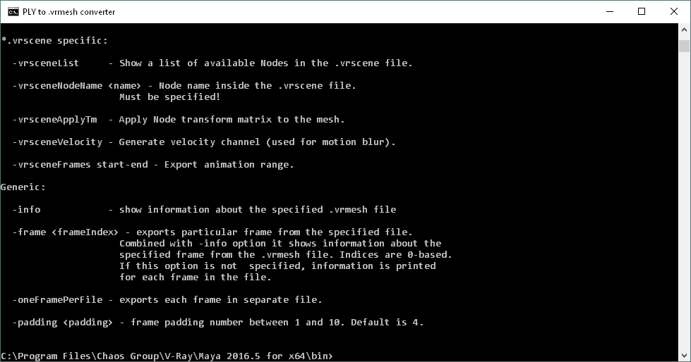

Generic
-info – Shows information about the specified .vrmesh file.
-perObject – Prints additional information for each object in the file. Requires the -info flag.
-frame <frameIndex> – Exports a particular frame from the specified file. Combined with -info option, it shows information about the specified frame from the .vrmesh file. Indices are 0-based. If this option is not specified, information is printed for each frame in the file.
-oneFramePerFile – Exports each frame in a separate file.
-padding <padding> – Frame padding number between 1 and 10. Default is 4.
These options can also be viewed from the command prompt by running the ply2vrmesh program without any parameters to see the description of these options.
