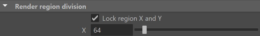

Lock region X and Y – Forces the bucket shape to a square by locking the region's X and Y (width and height) together. Enabled by default.
X – Determines the bucket's maximum region width in pixels (when Region W/H is selected for Measurement) or the number of regions in the horizontal direction (when Region Count is selected).
Y – Determines the bucket's maximum region height in pixels (when Region W/H is selected for Measurement) or the number of regions in the vertical direction (when Region Count is selected). This parameter is available only when Lock region X and Y is disabled.
