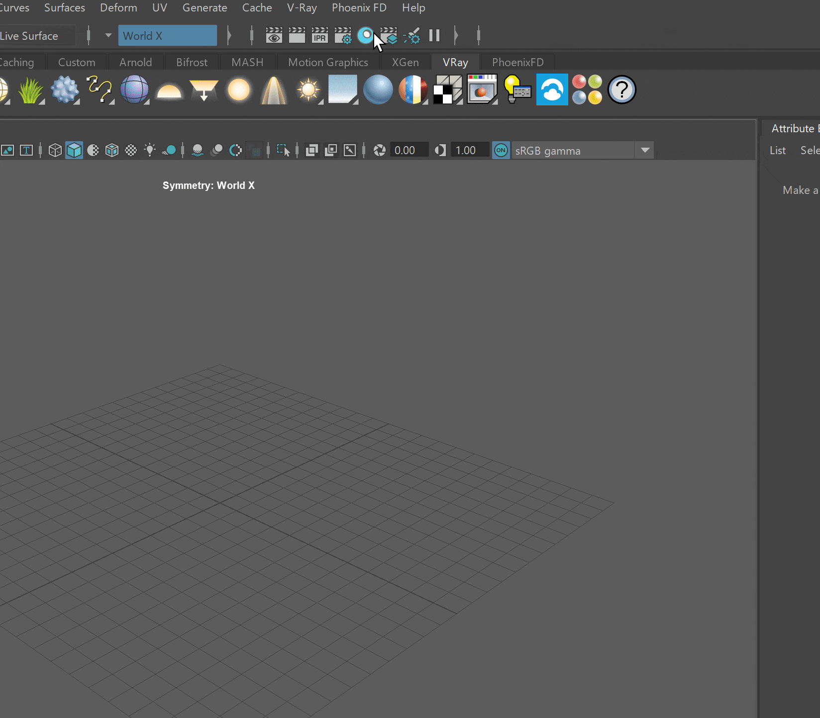

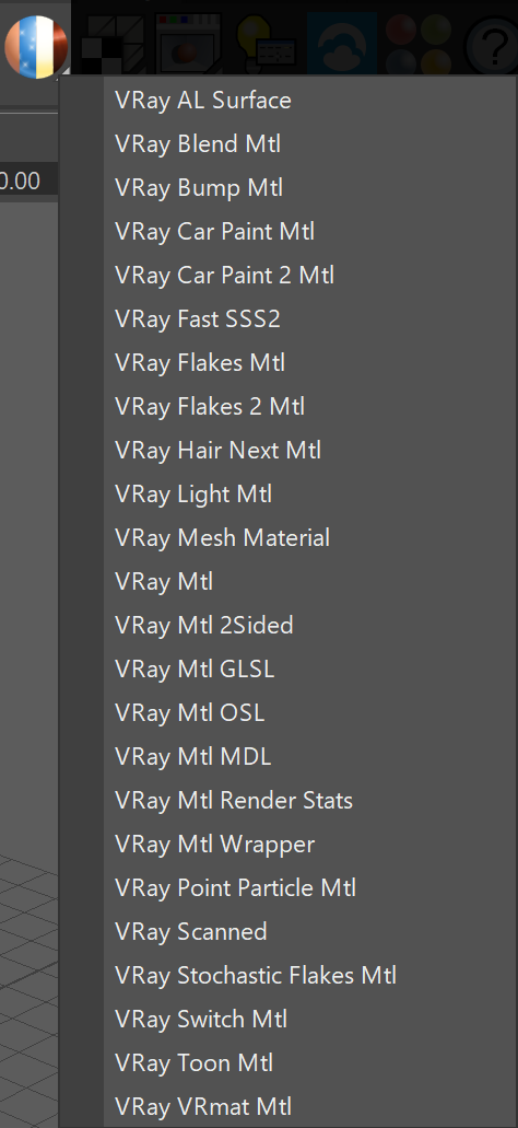

||Right-click on the geometry|| > Assign New Material... > VRay section > VRay Mtl 2Sided
||V-Ray Shelf|| > Right-click to Create V-Ray Materials button > VRay Mtl 2Sided
||Hypershade|| > Window tab > Create... > VRay section > VRay Mtl 2Sided

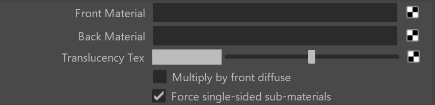

Front material – The material which is going to be used for front-side faces as defined by the object normals.
Back material – The material V-Ray will use for back side faces as defined by their normals.
Translucency tex – Determines which side (front or back) relative to the camera is more visible in the rendering process. By default this value is 0.5, which means that both the side facing the camera, and the one facing away from it, will be visible to the same degree. When this parameter is closer to 0.0 the more of the material facing the camera is going to be seen. When it is closer to 1.0, the more of the back material is seen.
Multiply by front diffuse – When enabled, the translucency is multiplied by the diffuse of the front material. This option is not available when the renderer is set to CUDA.
Force single-sided sub-materials – When enabled (the default), the sub-materials will render as one-sided materials. Turning this option off is not recommended.

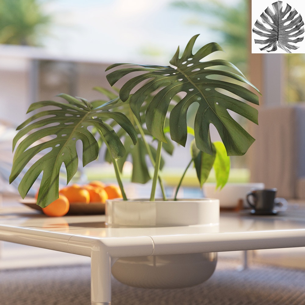

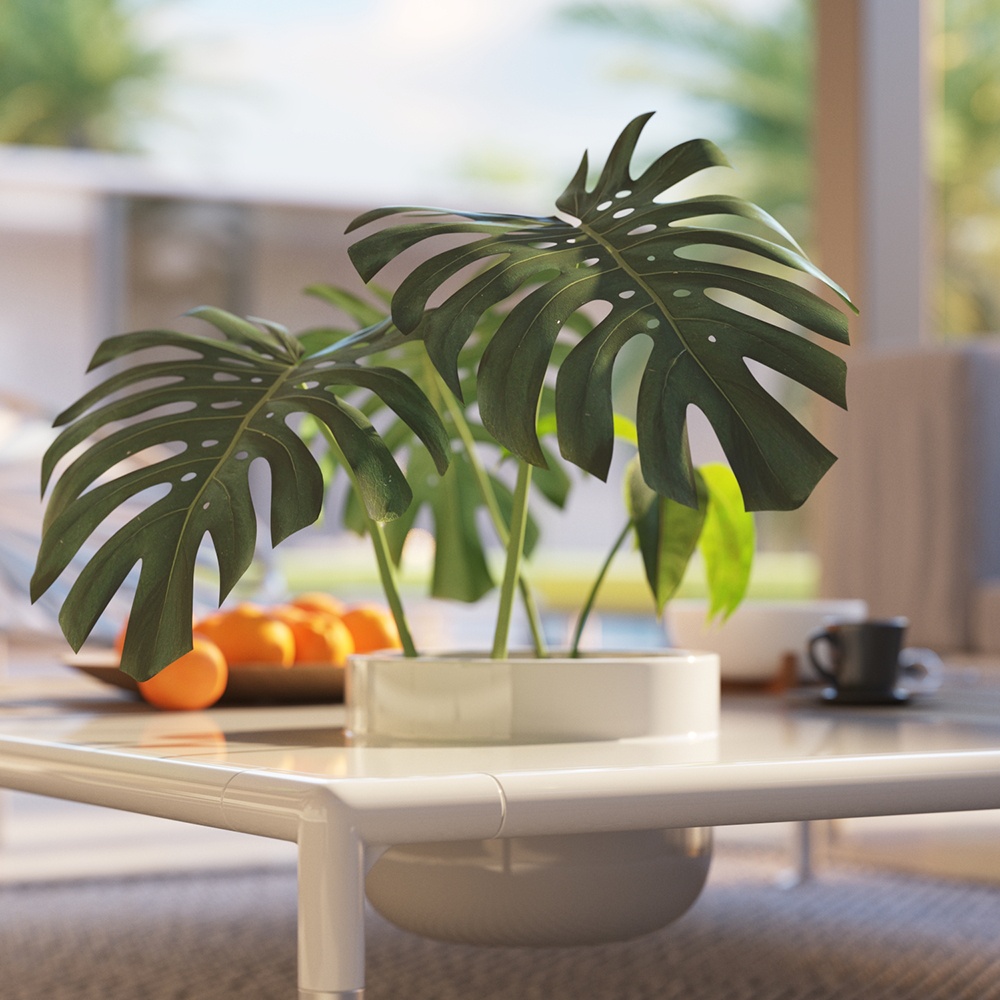

Example: Translucency Value (Front vs. Back Material)

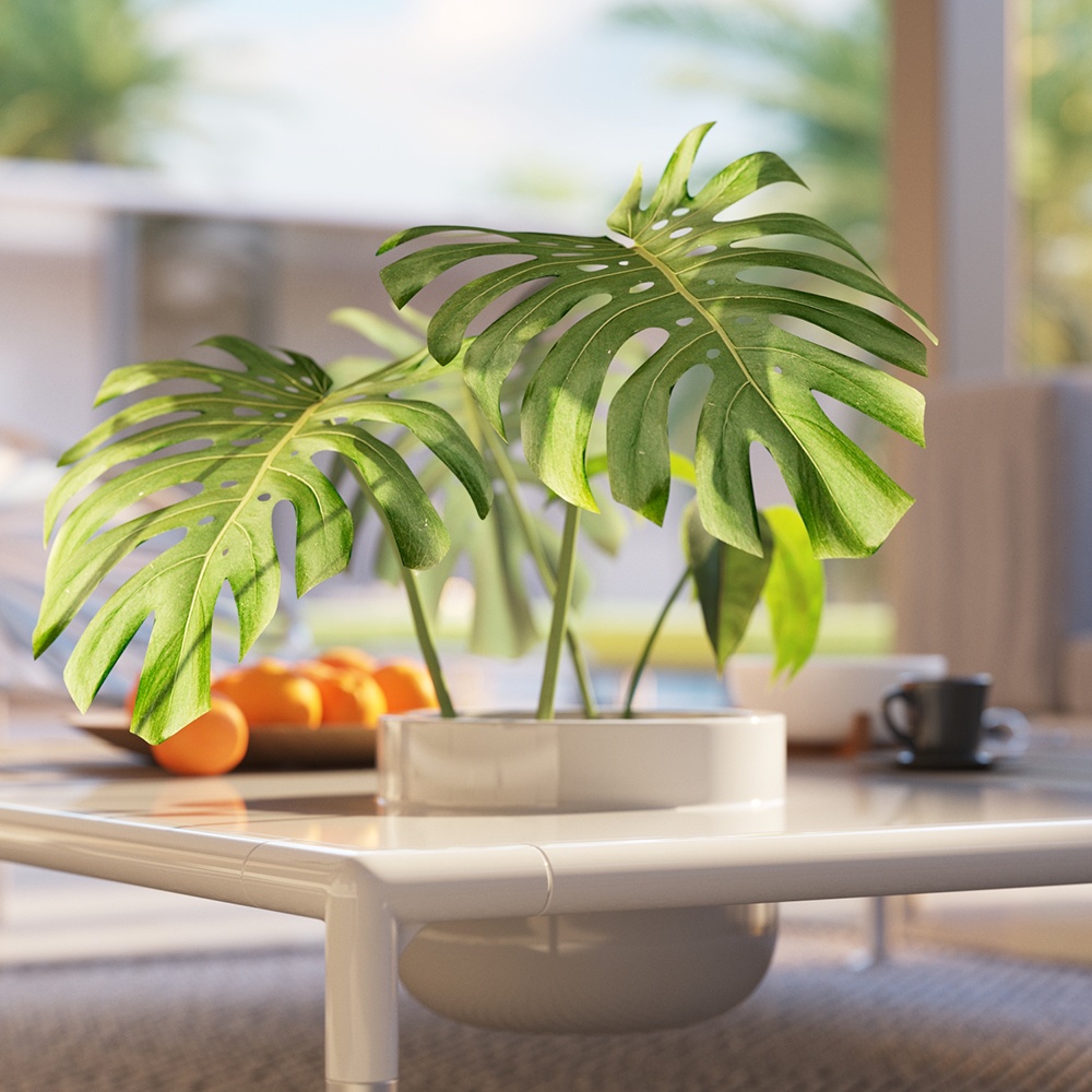

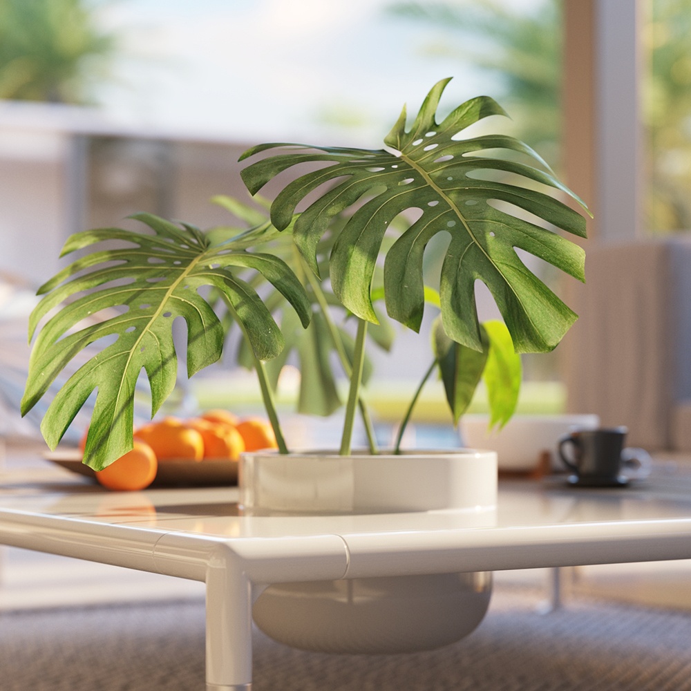

In this example, the leaves have both front and back materials connected to the VRayMtl2Sided Material. Notice how the leaves change when the Translucency value (shown in RGB) is changed. The last render uses a Translucency grayscale map.
Translucency (0, 0, 0)
Translucency (128, 128, 128)
Translucency (255, 255, 255)
Translucency map

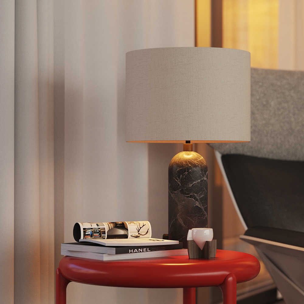

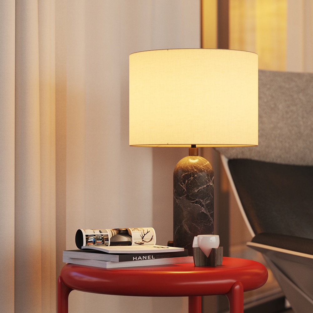

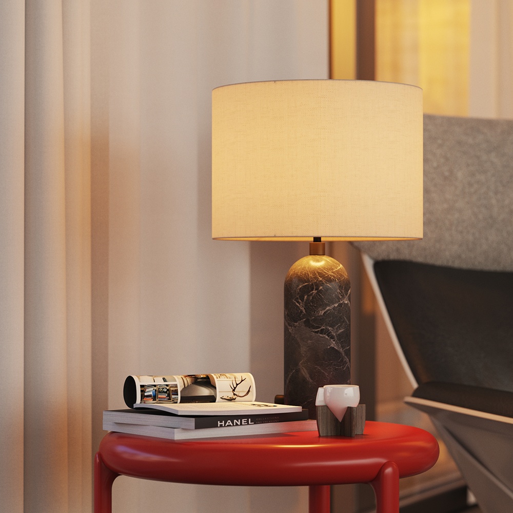

In this example, the lampshade uses a VRayMtl2Sided material with only a Front material connected (VRayMtl). A V-Ray sphere light is used to illuminate the inside. Translucency is shown here with grayscale values (RGB).
Translucency (64, 64, 64)
Translucency (192, 192, 192)

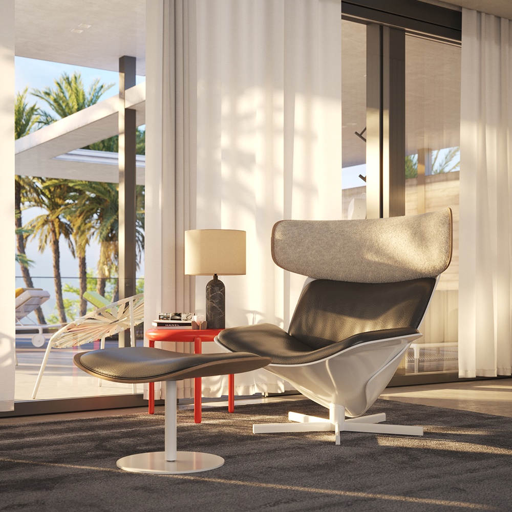

Example: Common Usage

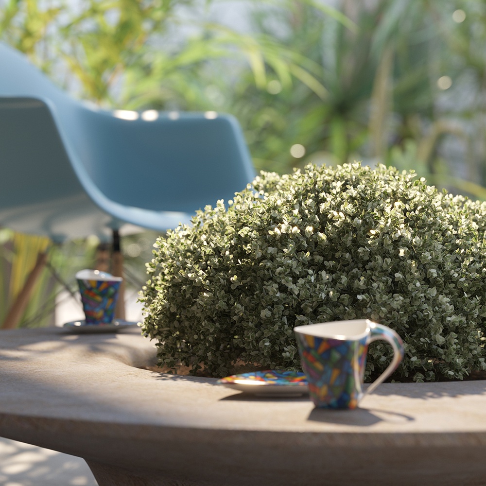

VRayMtl2Sided material is commonly used for leaves. Notice how the light illuminates the shrub from behind.
The curtain uses VRayMtl2Sided material to allow some outdoor light on the inside of this interior.
