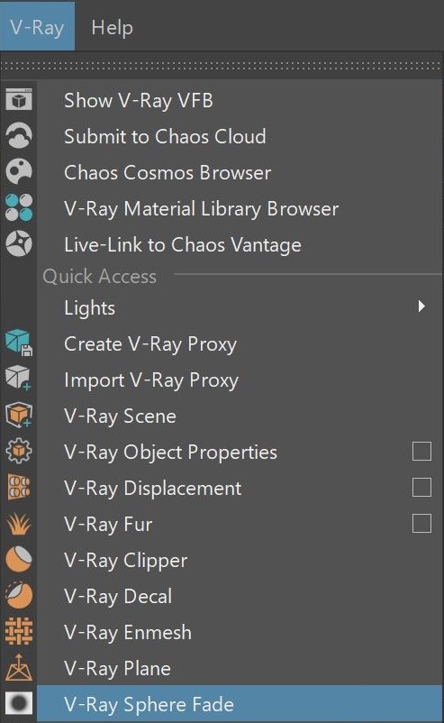

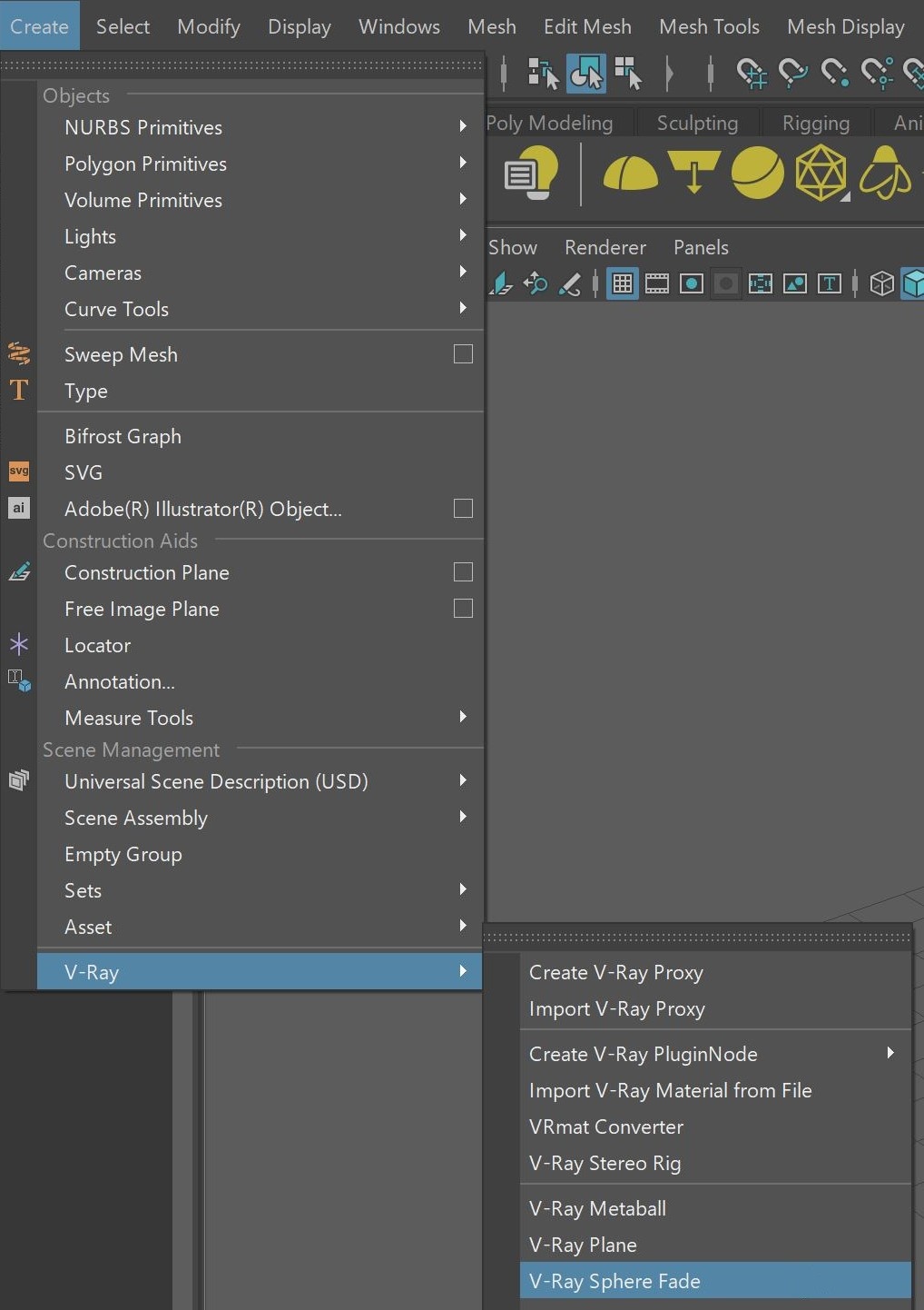

UI Path: ||Hypershade|| > Create panel > VRay section > Volumetric > VRay Sphere Fade Volume
||V-Ray Menu|| > V-Ray Sphere Fade
||Create menu|| > V-Ray > Create VRaySphereFade
Workflow
  • [Optional] Start an IPR to see scene updates in real time.
  • Create a VRaySphereFade node from the V-Ray menu > V-Ray Sphere Fade, or from the V-Ray Shelf. This automatically adds a VRaySphereFadeVolume as an environment volume override.
  • Adjust the Sphere Fade locator in the scene. Everything within the locator will be rendered.

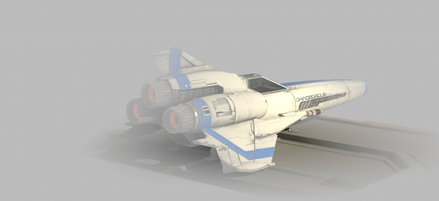

Example: Relative Falloff

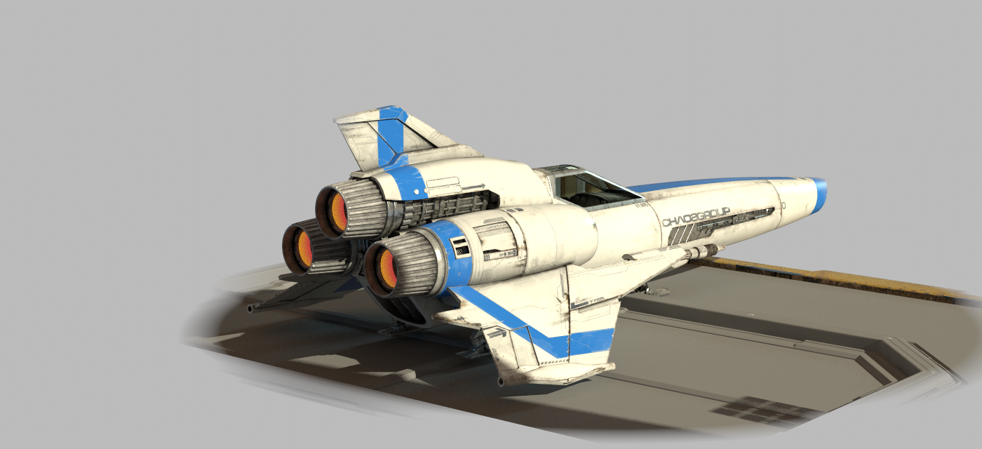

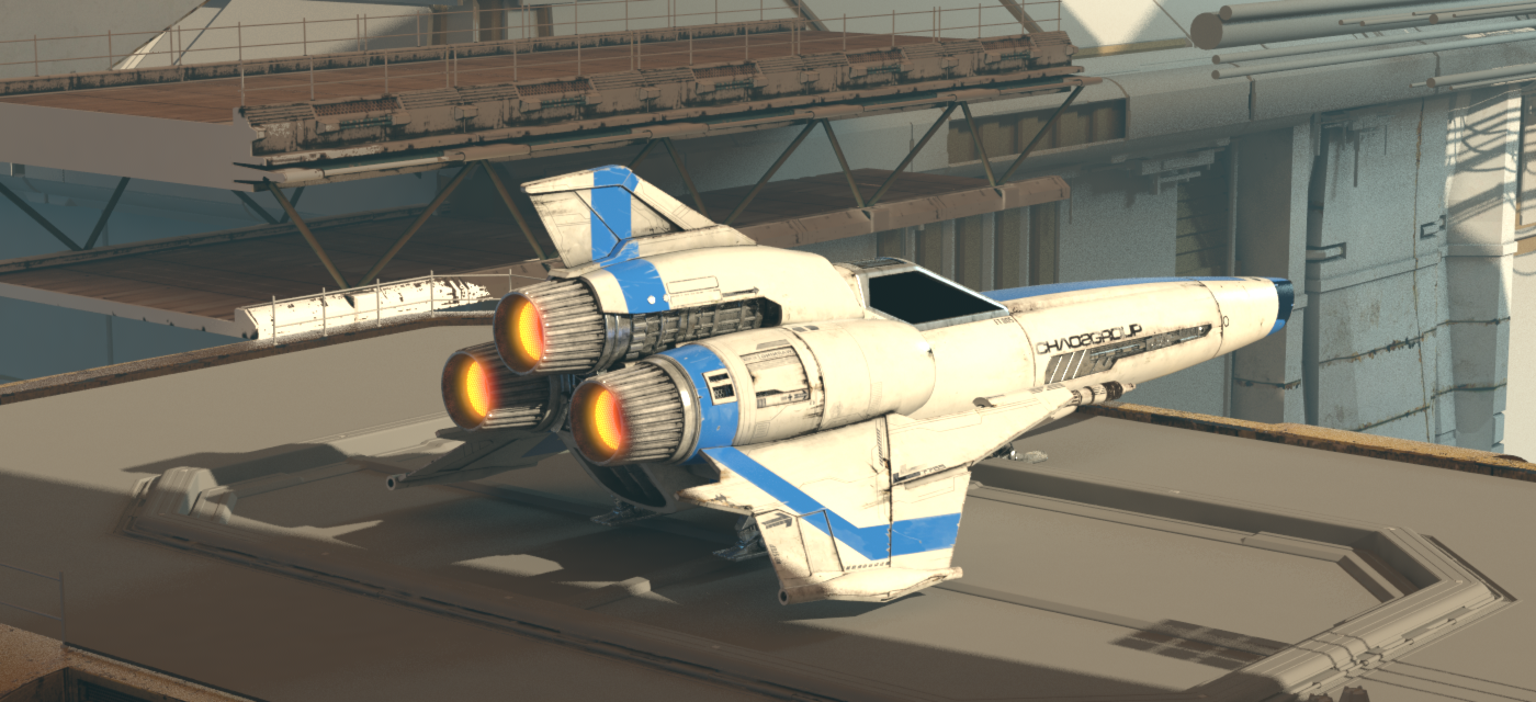

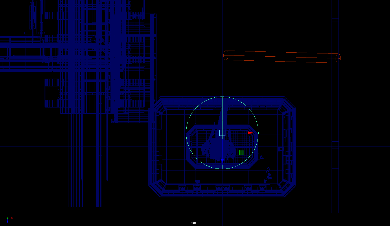

This example uses a VRaySphereFade locator with the Shape set to Sphere aligned with the the Viper fighter. We've set the radius to 390 so the locator is large enough to cover our object. This will provide the active area used by VRaySphereFade and has been added as an active object in the VRaySphereFade parameters list. By changing the value of the Falloff the amount of fade can be adjusted. The fade effect takes place from the locator itself inwards, so it must contain what you want to see in your render.
The Sphere locator has been aligned to the Viper fighter

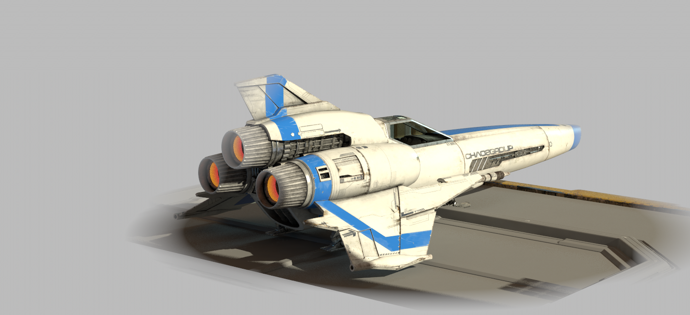

VRaySphereFade with Falloff turned off
VRaySphereFade Falloff with a value of 0.0
VRaySphereFade Falloff with a value of 0.1
VRaySphereFade Falloff with a value of 0.2
VRaySphereFade Falloff with a value of 0.4
VRaySphereFade Falloff with a value of 0.8

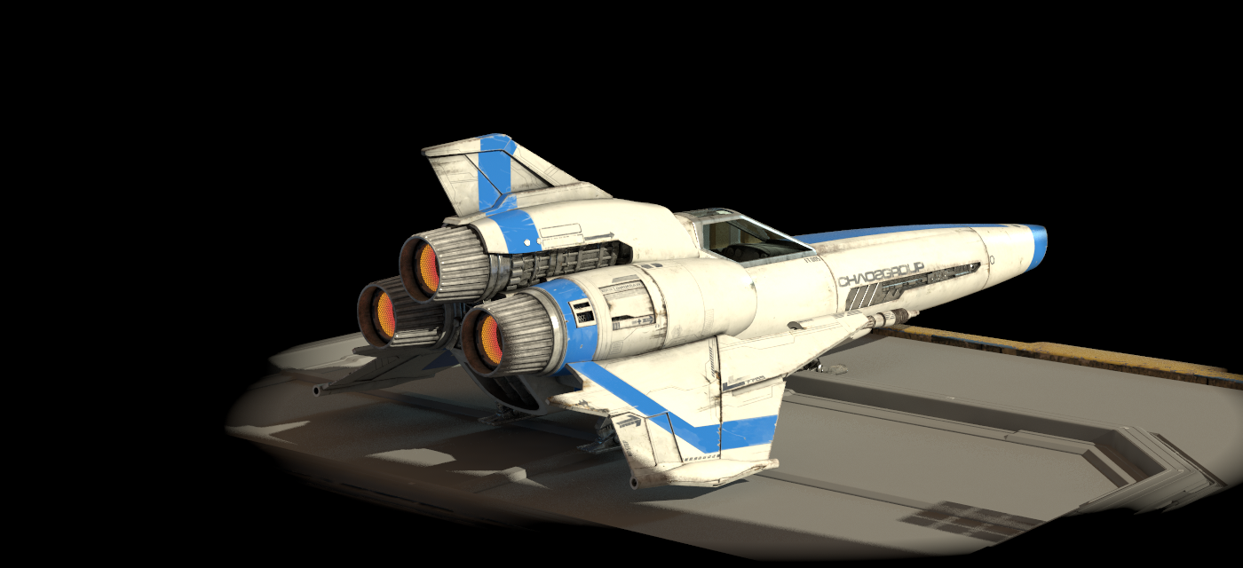

Example: Empty Color
Like the previous examples on this page, this one uses a VRaySphereFade with the Shape set to Sphere and the radius of 390 aligned to the Viper fighter. This will provide the active area used by VRaySphereFade and has been added as an active object in the VRaySphereFade parameters list. The Empty Color (the area outside of that affected by the VRaySphereFade locator and its falloff) can be changed from a default of mid-gray to any color required.

VRaySphereFade Empty color set to mid-grey
VRaySphereFade Empty color set to black
VRaySphereFade Empty color set to mid green

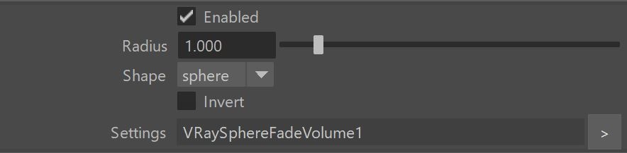

Sphere Fade Attributes
Enabled – Turns the particular VRaySphereFade object on and off.
Radius – Controls the size of the VRaySphereFade.
Shape – Adjusts the primitive dimensions between a Sphere, a Box, or a Cylinder.
Invert – Inverts the volume that is shaded, rendering the part of the scene that is outside the locator. For more information, please see the Invert example below.
Settings – Links to the VRaySphereFadeVolume attached to the locator.
