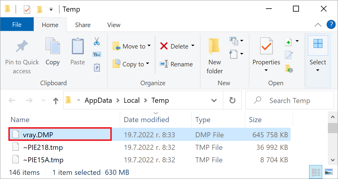

How to get the minidump file?
When the app crashes, a minidump file is automatically created in its designated folder. When using the app on Windows, the minidump file is stored in the %temp% folder by default.

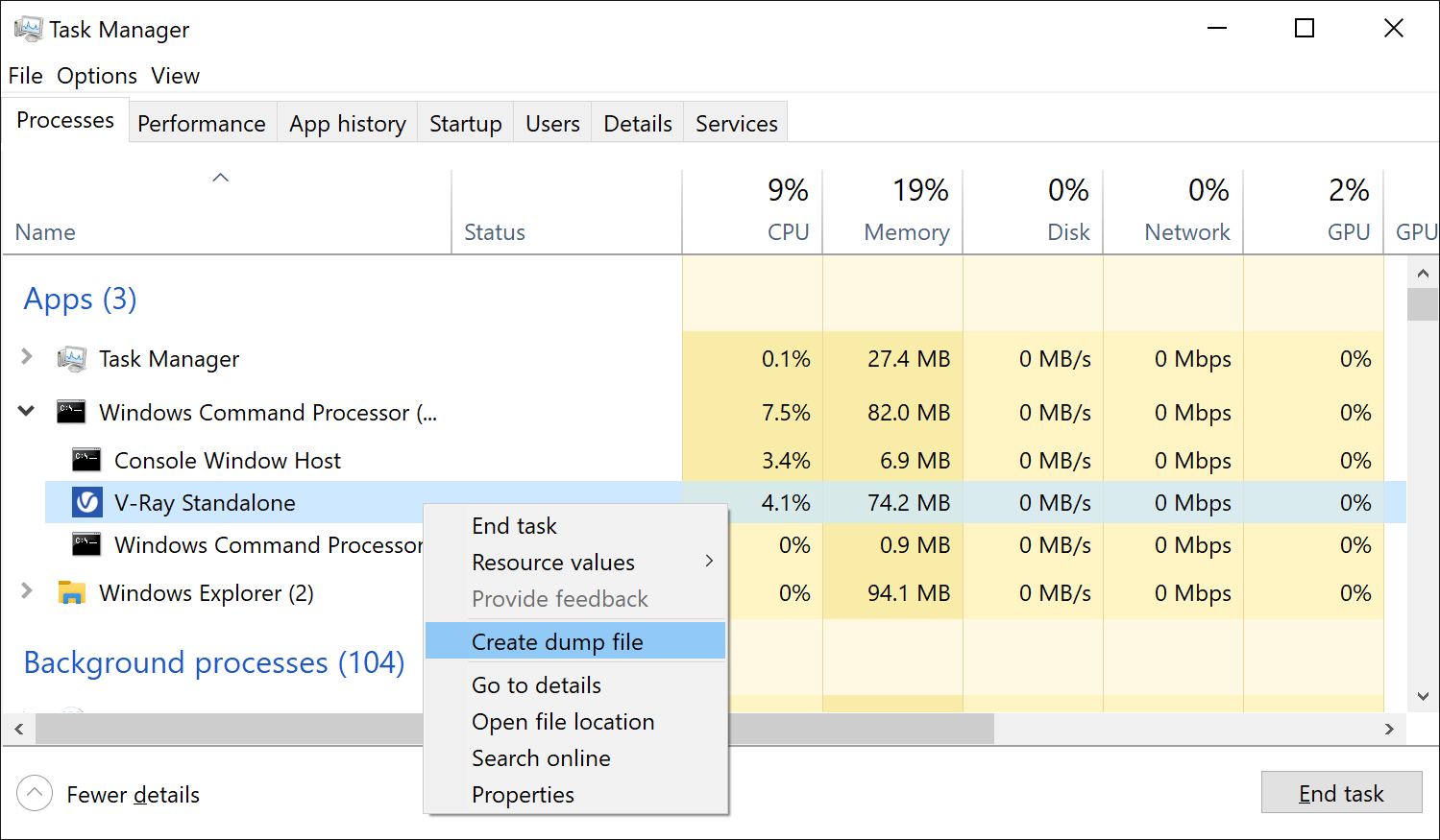

In case the crash dump file is missing from the its designated folder, you can create it manually. Depending on the OS you are using, you can do so:
  1. Open the Windows Task Manager from the Start Menu.
  2. Right-click on the V-Ray application in the Processes tab to select the Create dump file option, while the V-Ray app displays the notification that unexpected error has occurred.
3. The crash dump file is created in the Temp folder.
