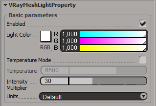

Basic Parameters
Enabled - turns the VRayMeshLightProperty on and off.
Light Color - the color of the light. When using photometric units, this color is normalized so that only the color hue is used, whereas the light intensity is determined by the Intensity Multiplier.
Temperature Mode - allows you to control the light color using the Temperature parameter
Temperature - when the Temperature Mode is enabled this parameter controls the color of the light.
Intensity Multiplier - multiplier for the light color; this is also the light intensity in the units chosen by the intensity units parameter.
Units - allows you to choose the light units. Using correct units is essential when you are working with the VRayPhysicalCamera. The light will automatically take the scene units scale into consideration to produce the correct result for the scale you are working with. The possible values are:
  • Default (image) - the color and multiplier directly determine the visible color of the light without any conversion. The light surface will appear with the given color in the final image when seen directly by the camera (assuming there is no color mapping involved).
  • Lumious power (lm) - total emitted visible light power measured in lumens. When this setting is used, the intensity of the light will not depend on its size. A typical 100W electric bulb emits about 1500 lumens of light.
  • Luminance (lm/m²/sr) - visible light surface power measured in lumens per square meter per steradian. When this setting is used, the intensity of the light depends on its size.
  • Radiant power (W) - total emitted visible light power measured in watts. When using this setting, the intensity of the light does not depend on its size. Keep in mind that this is not the same as the electric power consumed by a light bulb for example. A typical 100W light bulb only emits between 2 and 3 watts as visible light.
  • Radiance (W/m²/sr) - visible light surface power measured in watts per square meter per steradian. When this setting is used, the intensity of the light depends on its size.

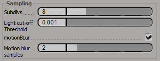

Sampling
Subdivs - this value controls the number of samples V-Ray takes to compute lighting. Lower values mean more noisy results, but will render faster. Higher values produce smoother results but take more time. Note that the actual number of samples also depends on the DMC Sampler settings.
Light cut-off threshold - this parameter specifies a threshold for the light intensity, below which the light will not be computed. This can be useful in scenes with many lights, where you want to limit the effect of the lights to some distance around them. Larger values cut away more from the light; lower values make the light range larger. If you specify 0.0, the light will be calculated for all surfaces.
Motion Blur - allows you to override the default number of samples that will be used to sample the current light for motion blur.
Motion blur samples - when the Motion Blur is enabled this value will be used when sampling the motion blur created by the current light.

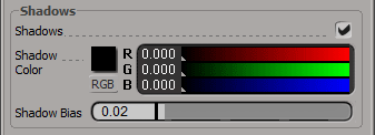

Shadows
Shadows - when on (the default), the light casts shadows. Turn this option off to disable shadow casting for the light.
Shadow Color - this parameter controls the color of shadows for this light. Note that anything different from black is not physically correct.
Shadow bias - the Shadow bias moves the shadow toward or away from the shadow-casting object (or objects). If the value is too low, shadows can "leak" through places they shouldn't, produce moire patterns or create out-of-place dark areas on meshes. If the Shadow bias is too high, shadows can "detach" from an object. If the value is too extreme in either direction, shadows might not be rendered at all.

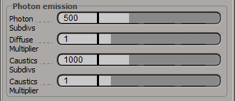

Photon Emission
Photons subdivs - this value is used by V-Ray when calculating the Global Photon Map. Lower values mean more noisy results, but will render faster. Higher values produce smoother results but take more time.
Diffuse multiplier - a multiplier for the diffuse photons
Caustics subdivs - this value is used by V-Ray when calculating Caustics. Lower values mean more noisy results, but will render faster. Higher values produce smoother results but take more time.
Caustics multiplier -this value is a multiplier for the generated caustics by the selected light. Note that this multiplier is cumulative - it does not override the multiplier in the Caustics.
