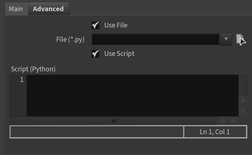

Use File – Enable to use a Python post-translate file.
File – Adds a Python post-translate file.
Use Script – Enable to use a Python post-translate script.
Script (Python) – Adds a Python post-translate script.

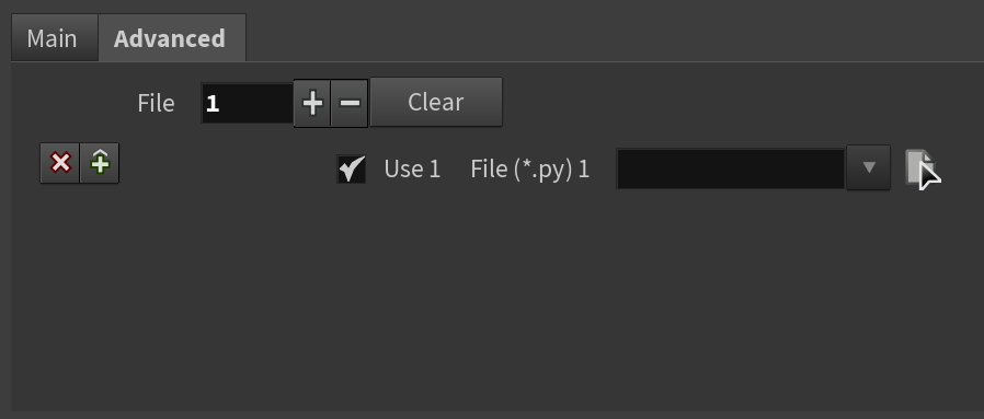

File – Shows the number of post-translate files.
Add – Adds another instance.
Delete– Removes last instance.
Clear – Clears all instances.
Remove – Removes a post-translate file.
Insert Before – Inserts a post-translate file before the current file.
Use – Enable to use the post-translate file.
File (*.py) – Adds a post-translate file.

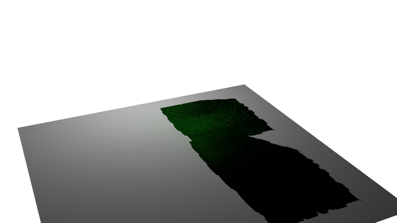

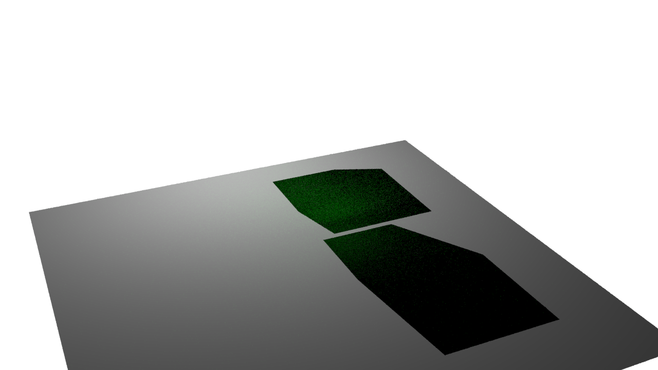

Example: Automatically Switch off Displacement for Phantom objects
import vray
from vfh import vfh_utils
renderer = vray.VRayRenderer()
for node in renderer.plugins:
    if node.getType() != 'Node':
        continue
    if not node.object_properties:
        continue
    objProps = node.object_properties
    needFix = objProps.camera_visibility == 0 or objProps.matte_surface == 1
    if not needFix:
        continue
    instancer = node.geometry
    if not instancer.instances:
        continue
    for instance in instancer.instances[1:]: # First item is time
        instancedNode = instance[-1] # Node is last
        if type(instancedNode) is not vray.Plugin:
            continue
        if instancedNode.getType() != 'Node':
            continue
        if instancedNode.geometry.getType() in {'GeomDisplacedMesh', 'GeomStaticSmoothedMesh' }:
            instancedNode.geometry = instancedNode.geometry.mesh
            vfh_utils.syslog("Disabling displacement for \'%s\"" % instancedNode)
Here, you can check how the script changes the render.
