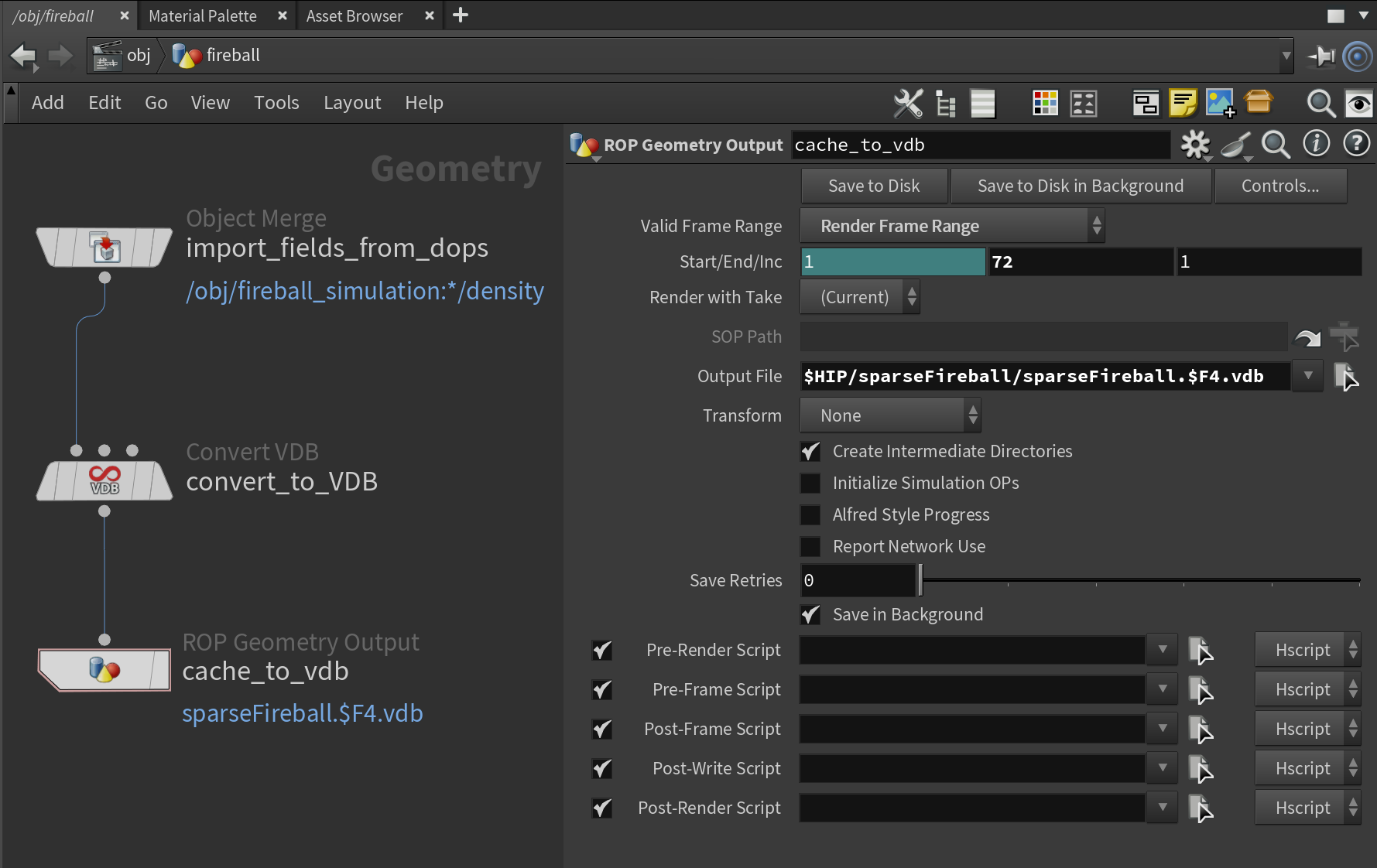

1. Go inside the |obj| network and dive into the node you want to convert. Cache to disk in the VDB format.

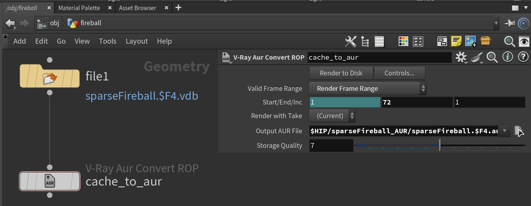

2. Then cache to aur to save to AURA with the help of the V-Ray Aur Convert ROP.

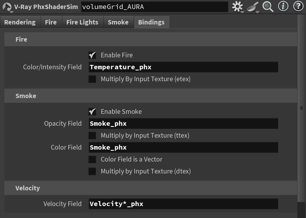

Therefore, when applying the Volume Shader material to the cached AURA files, make sure to set up the proper names in the Bindings tab of the shader:

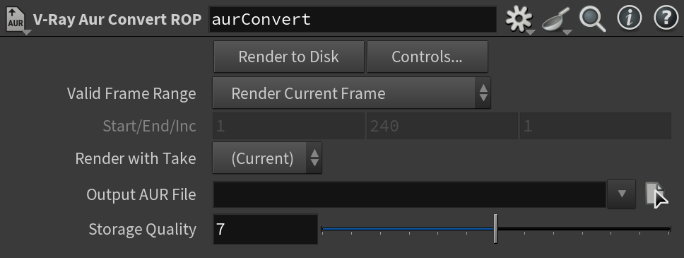

Render to Disk – Starts a V-Ray render.
Controls – Launches the Houdini Render Control window.
Valid Frame Range – Specifies the frame(s) to render.
Render Current Frame – Renders the current frame.
Render Frame Range – Renders frames from the specified range set below as well as other frames if they are referenced by in-range frames.
Render Frame Range Only (Strict) – Only renders the frames in the specified range set below.
Start/End/Inc – Specifies the range of frames to render (start frame, end frame, and increment).
Render with Take – Renders using the settings from a specified take.
Output AUR File – A path to the output .aur file.
Storage Quality – Storage quality of the output .aur (lowest means max compression, highest means lossless).
