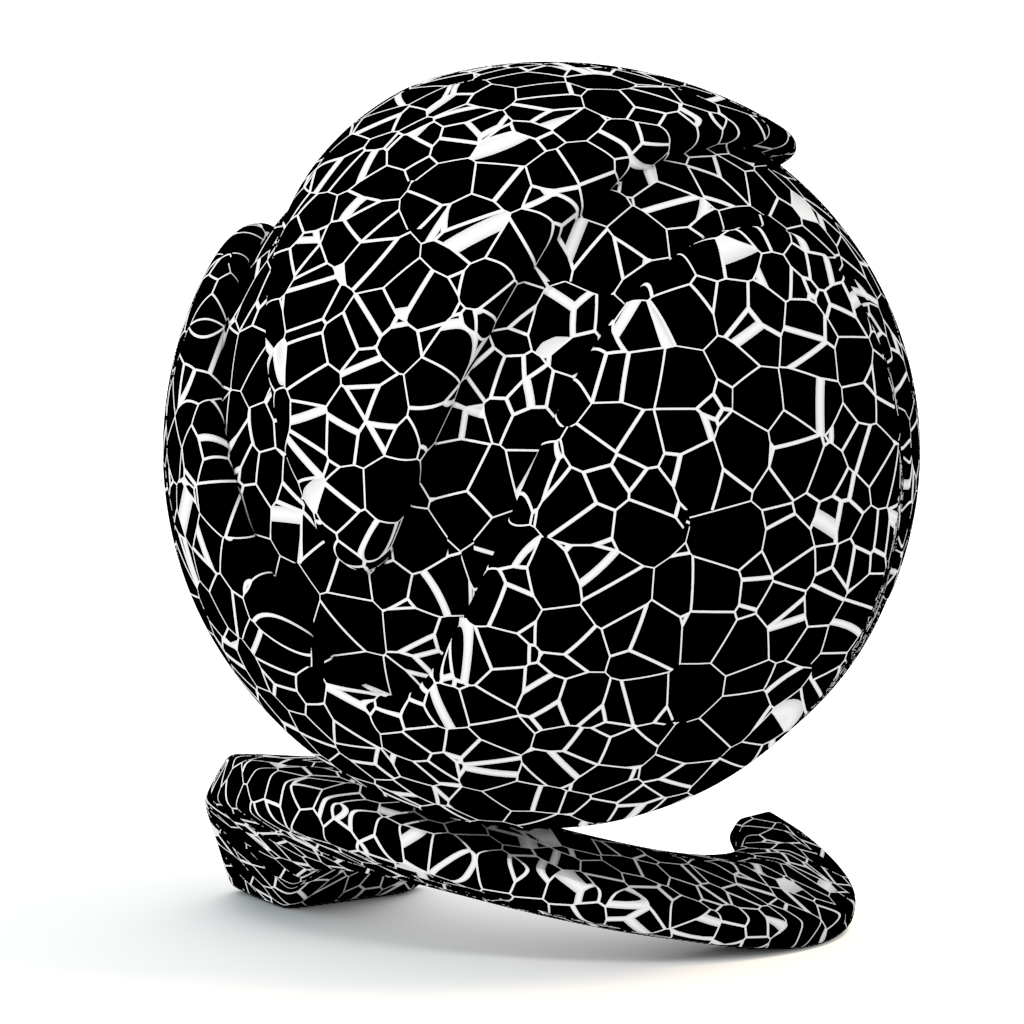

The V-Ray Cellular Texture map generates a procedural cellular noise pattern.

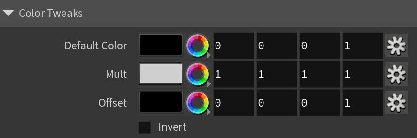

Color Tweaks
Default Color – Specifies a color when there are no valid uvw coordinates.
Mult – Specifies a multiplier for the texture color.
Offset – Color corrects the texture by adding the RGB color values specified here to the RGB color values in the texture.
Invert – When enabled, the resulting texture color is inverted.

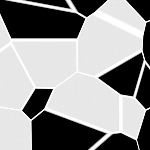

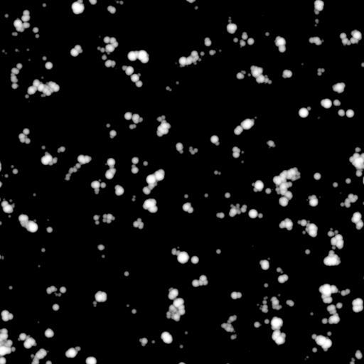

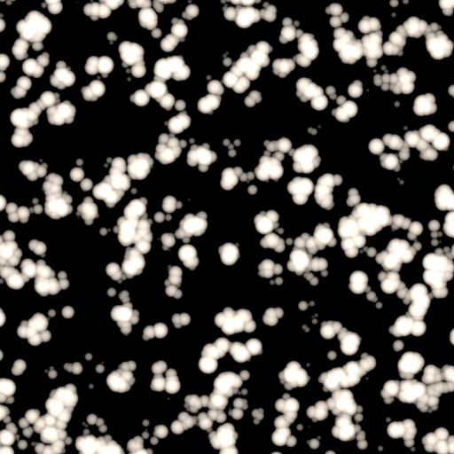

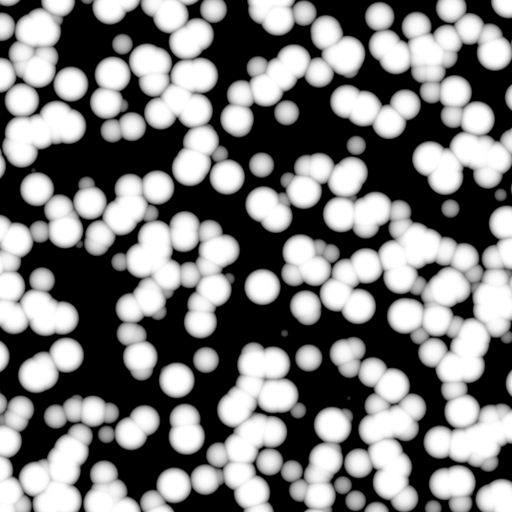

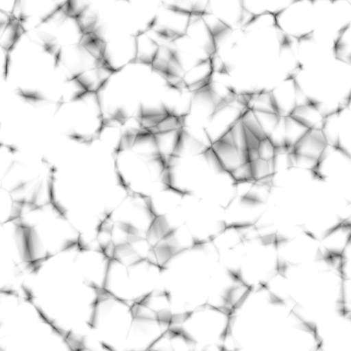

Example: Size

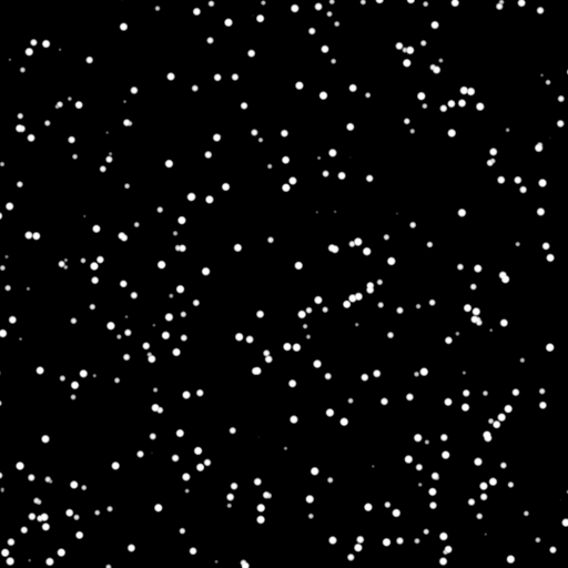

Dots Size: 0.05
 Dots Size: 0.1
Dots Size: 0.2

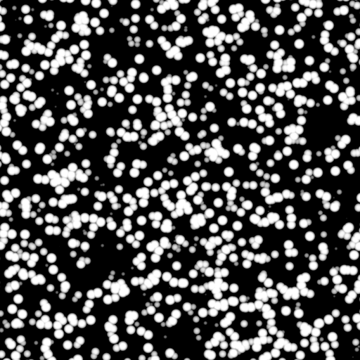

Chips Size: 0.2
Chips Size: 0.35
 Chips Size: 0.5

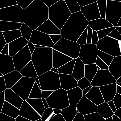

Cells Size: 0.1
Cells Size: 0.2
Cells Size: 0.5

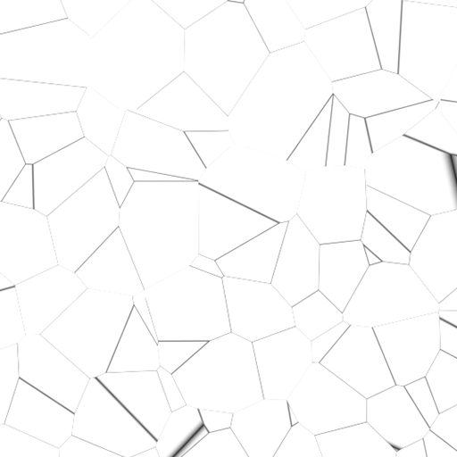

Chess Cells Size: 0.1
Chess Cells Size: 0.2
Chess Cells Size: 0.5
 Plasma Size: 0.05
Plasma Size: 0.07
Plasma Size: 0.2
Move the slider to see the example renders.

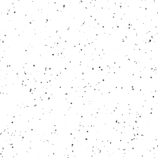

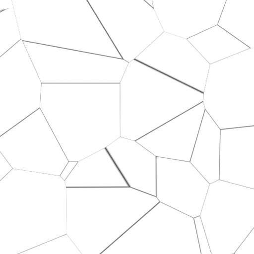

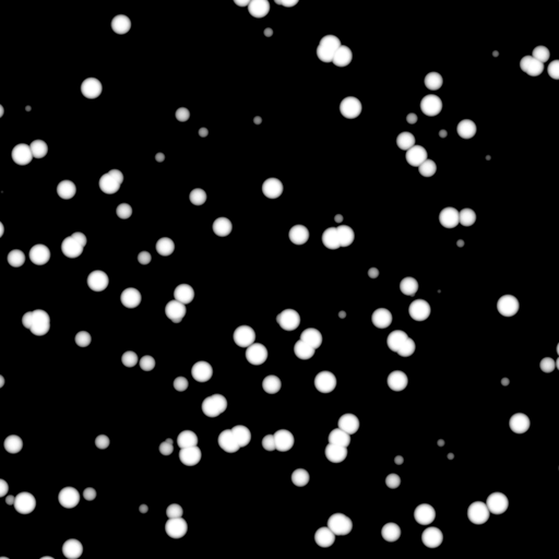

Example: Spread
Dots Spread: 0.5
Dots Spread: 1.0
 Dots Spread: 1.5
Chips Spread: 0.5
Chips Spread: 1.0
 Chips Spread: 2.0
 Cells Spread: 0.1
 Cells Spread: 0.5
 Cells Spread: 1.0
Chess Cells Spread: 0.1
Chess Cells Spread: 0.5
 Chess Cells Spread: 0.9
 Plasma Spread: 1.0
Plasma Spread: 3.0
Plasma Spread: 5.0

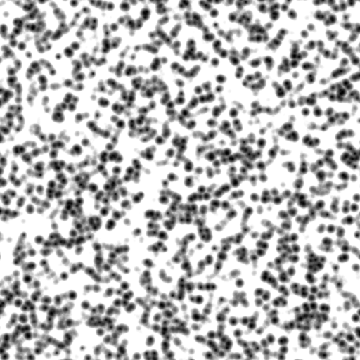

Example: Density
Dots Density: 0.1
 Dots Density: 0.25
Dots Density: 1.0
Chips Density: 0.25
Chips Density: 0.7
Chips Density: 1.5
Cells Density: 0.15
Cells Density: 0.25
 Cells Density: 0.5
Chess Cells Density: 0.15
 Chess Cells Density: 0.25
Chess Cells Density: 0.5
Plasma Density: 0.5
 Plasma Density: 1.0
Plasma Density: 2.0

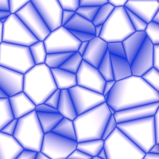

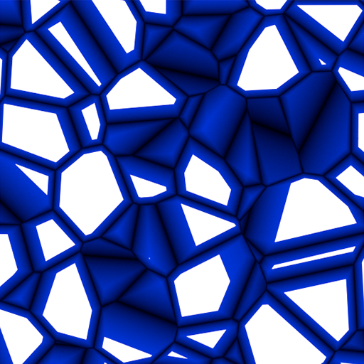

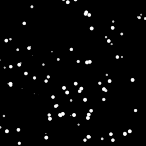

Example: Low
The Dots examples below use Size: 0.25, Spread: 0.5, and Density: 1.5. The Edge Color is blue for visual clarity.
Dots Low: 0.0
Dots Low: 0.5
Dots Low: 1.0
The Chips examples below use Size: 1.0, Spread: 0.75, and Density: 3.0. The Edge Color is blue for visual clarity.
Chips Low: 0.0
Chips Low: 0.5
Chips Low: 0.9

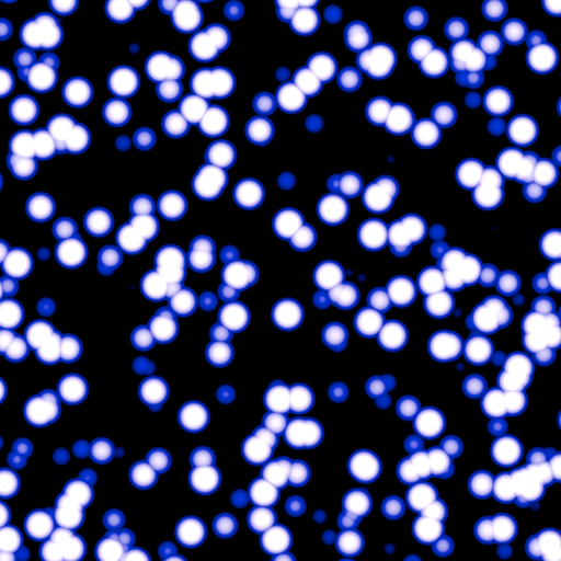

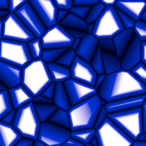

Example: Middle
Dots Middle: 0.0
Dots Middle: 0.5
Dots Middle: 1.0
Chips Middle: 0.0
Chips Middle: 0.5
Chips Middle: 1.0

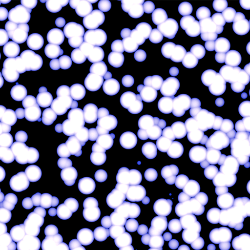

Example: High
Dots High: 0.0
Dots High: 0.75
Dots High: 1.0
Chips High: 0.0
Chips High: 0.75
Chips High: 1.0

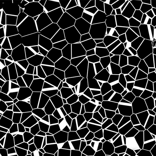

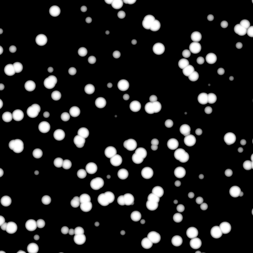

Example: Fractal Iterations
Fractal not enabled
 Fractal Iterations: 1.75
 Fractal Iterations: 3.0
Fractal not enabled

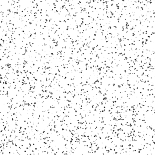

Example: Fractal Roughness
The Dots examples below use Size: 0.25, Spread: 0.5, Density: 1.5, and Fractal Iterations: 3.0.
Fractal Roughness: 0.0
Fractal Roughness: 0.5
 Fractal Roughness: 0.9
The Chips examples below use Size: 1.0, Spread: 0.75, Density: 3.0, and Fractal Iterations: 3.0.
