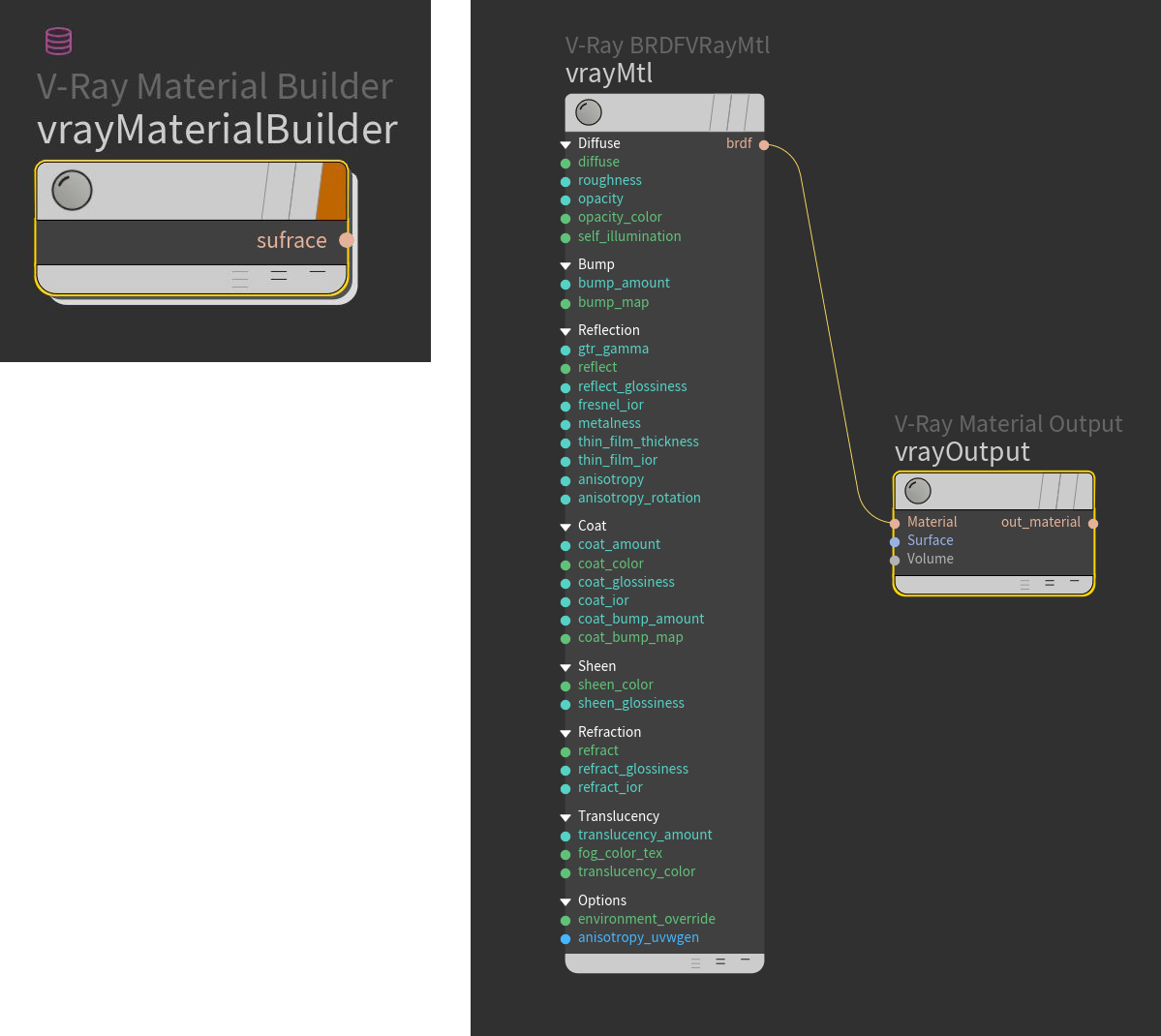

The V-Ray Material Builder node is a container that allows the creation of various V-Ray materials. By default, it creates a BRDFVRayMtl connected to a V-Ray Material Output node. From here, a variety of V-Ray nodes can be created such as BRDF and utility material nodes, textures, mapping nodes, and atmospheric effects.

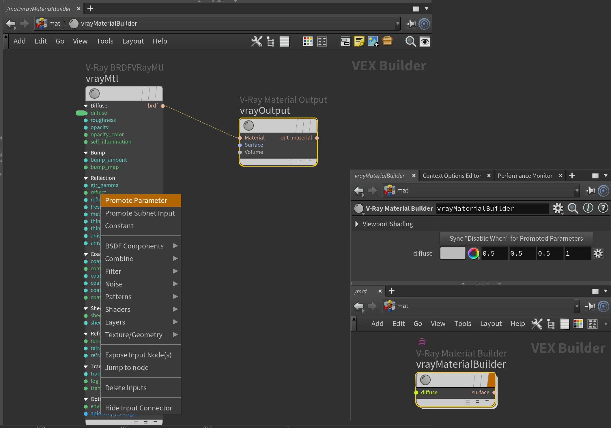

Sync "Disable When" for Promoted Parameters – Promoting a parameter copies its original data, potentially causing incorrect disabling of the promoted parameter's UI depending on the connected inputs. Click the Sync "Disable When" for Promoted Parameters button to rectify this. For example, if you promote the Reflection color of a V-Ray Material inside a V-Ray Material Builder, and then you link a V-Ray Color Correction texture to the promoted input, the Reflection color input won't disabled automatically.
Promote Parameters
To promote a V-Ray parameter dive inside a V-Ray Material Builder node and locate the material/texture node whose parameter you wish to promote.
Click with the middle mouse button on the parameter in the node and select Promote Parameter. The promoted parameter gets a marker to indicate that it has been promoted, and is also visible in the V-Ray Material Builder node’s parameters.
