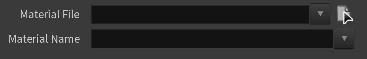

Material File – Selects the .vrmat.vismat, or .vrscene file to open.
Material Name – Specifies which material tree to use, e.g. Top-level <Asset> name or MtlSingleBRDF name if .vrscene.
