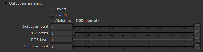

Output Parameters
These parameters can adjust the transition between Front Color and Side Color over the Falloff Map's gradient.
Invert – Inverts the color values.
Clamp – Clamps the color values.
Alpha from RGB intensity – Takes the alpha information from the intensity of the RGB.
Output amount – Determines the alpha multiplier.
RGB offset – Allows a color offset to the produced RGB values.
RGB level – Determines the intensity of the falloff effect.
Bump amount – Defines how much bump is produced.
