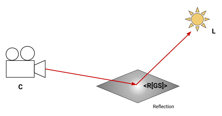

We can further specify the kind of hit we want to trace by combining R and T with one or more scattering types - diffuse (D), glossy (G), or singular (S). If we don’t specify that, all scattering types are assumed for our R or T events.
This allows us to filter the results only from diffuse reflection, for example with <RD> or combine glossy and singular reflection <R[GS]> .

A single hit for glossy and singular reflection.
C<R[GS]>L (Direct Specular)
