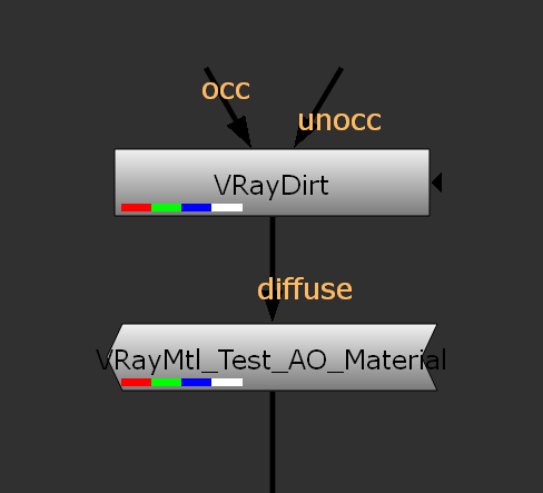

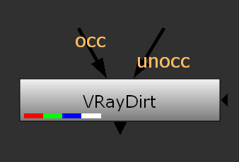

1.  Create a VRayDirt texture.
2.  Create a VRayMtl, name it VRayMtl_TestAO_Material and then connect the VRayDirt texture as its diffuse input.
3.  Connect the VRayMtl_Test_AO_Material to the img input of the geometry within the scene.

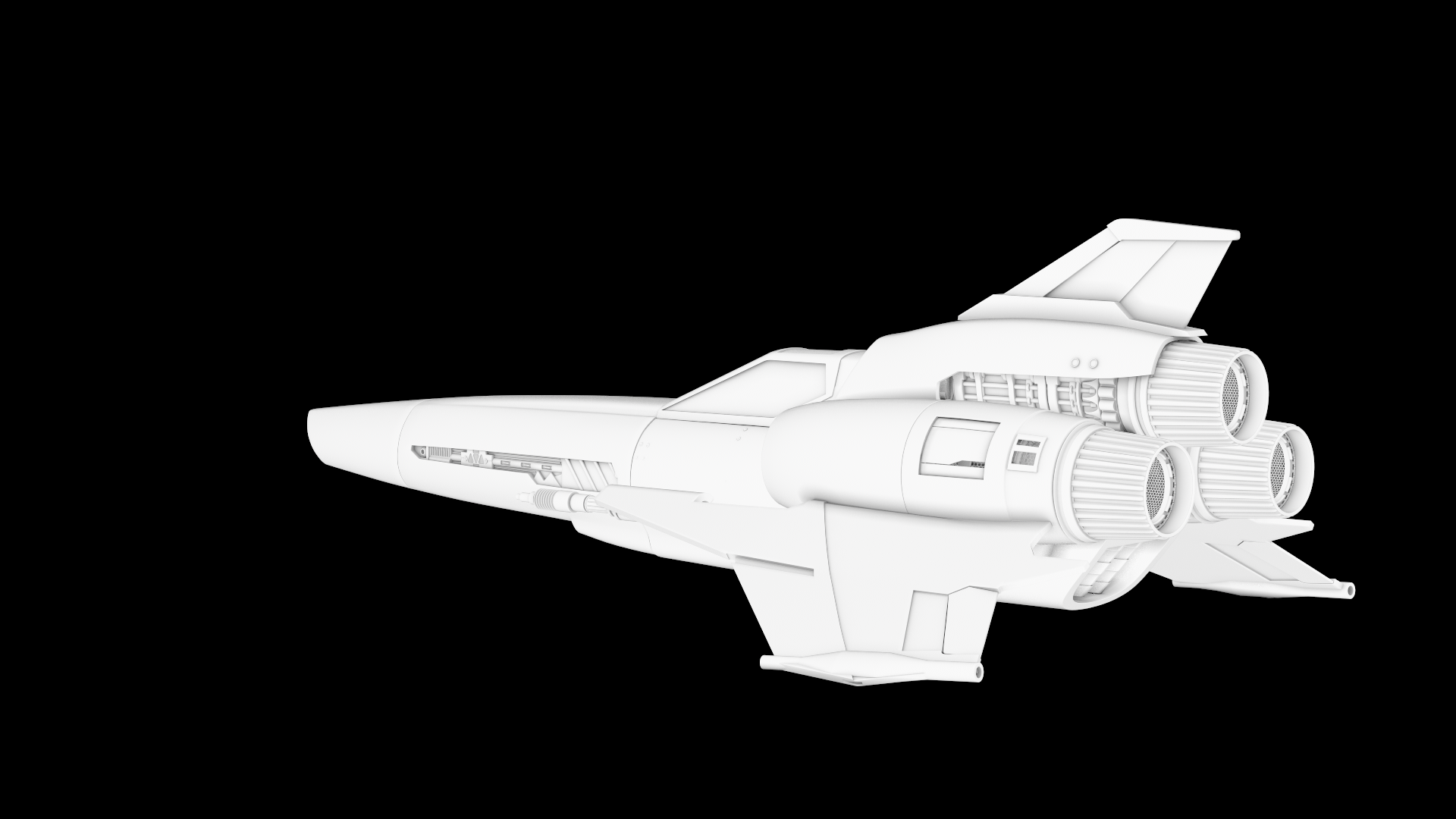

The Diffuse Render Element with VRayDirt used as the Diffuse channel for V-Ray Material, which currently only uses the default values for VRayDirt.
4. Currently at the default VRayDirt settings, there are not a lot of dark areas to later use to blend the two materials. So using the test VRayMtl we have set up so far, the VRayDirt texture can be tuned to reach the look desired to act as that blending mask when we eventually use the VRayMtlBlend. For tuning, it is easier if the viewer in Nuke is set to the diffuse channel.
In the examples below, the VRayDirt texture has been tuned to give it a darker and broader output, by using a large Radius of 1000 and a high Distribution value of 75 (which tightens the dark areas). Also, the Subdivs have been raised to 8 so that the resulting texture is not overly noisy.

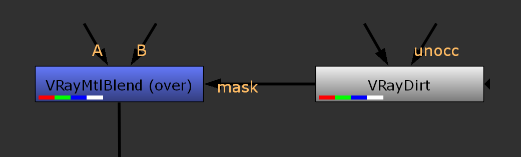

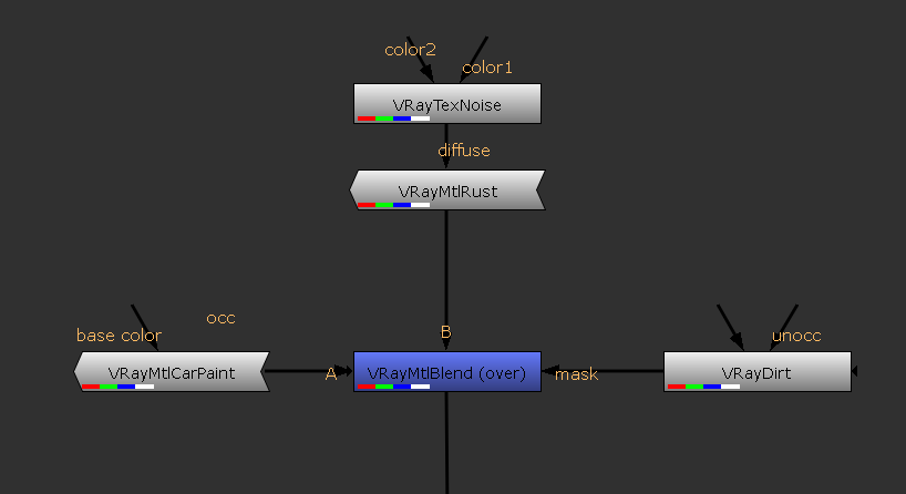

1.  Create a VRayMtlBlend material and connect the VRayDirt texture as a mask.
2.  Create a VRayMtl material, name it VRayMtlRust, and connect the B input of the VRayMtlBlend material.
3.  Create a VRayTexNoise texture and connect it to the diffuse input of the VRayMtlRust material. This acts as a basic rust color and gives some mild variation to the diffuse channel.
4.  Create a VRayMtlCarPaint material, name it VRayMtlCarPaint, and connect the A Input of the VRayMtlBlend material.
A Beauty Render of VRayMtlBlend with a VRayDirt acting as a mask between VRayMtlRust & VRayMtlCarPaint
