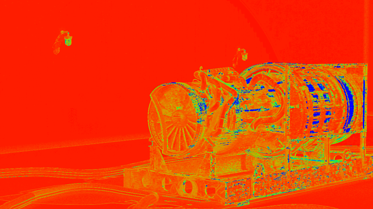

In the next image, the sampler did not have a high enough Max Subdivs value to hit the desired noise level. The high amount of red shows that the image sampler cut off sampling before the image hit the desired noise level. Noise can be decreased by increasing the Max Subdivs parameter to allow the image sampler to reach the desired noise level. Click on the image to view a larger version.
The Sample Rate Render Element
Render time = 7m 05s, Max Subdivs = 8, Noise Threshold = 0.01, Min shading rate = 6
The Image sampler was mostly not able to reach the specified noise threshold for most of the image.

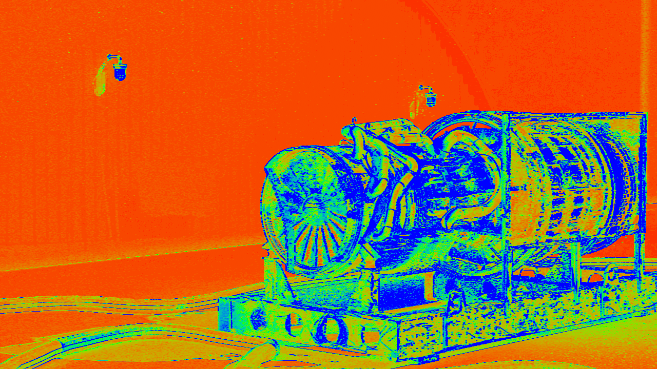

The primary samples can be allocated to the complex areas of the image by increasing both the Max Subdivs and the Noise Threshold values. This way, V-Ray has available enough primary samples to lower the noise of the complex areas in exchange for an overall slight increase in noise, while still keeping the render times down.
Render time = 8m 37s, Max Subdivs = 30, Noise Threshold = 0.02, Min shading rate = 6
Sample Rate Render Element with not enough max subdivs.
The Image sampler was mostly not able to reach the specified noise threshold.
