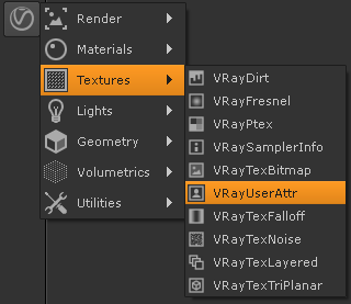

UI Path: ||Toolbar|| > V-Ray menu icon > Textures > VRayUserAttr

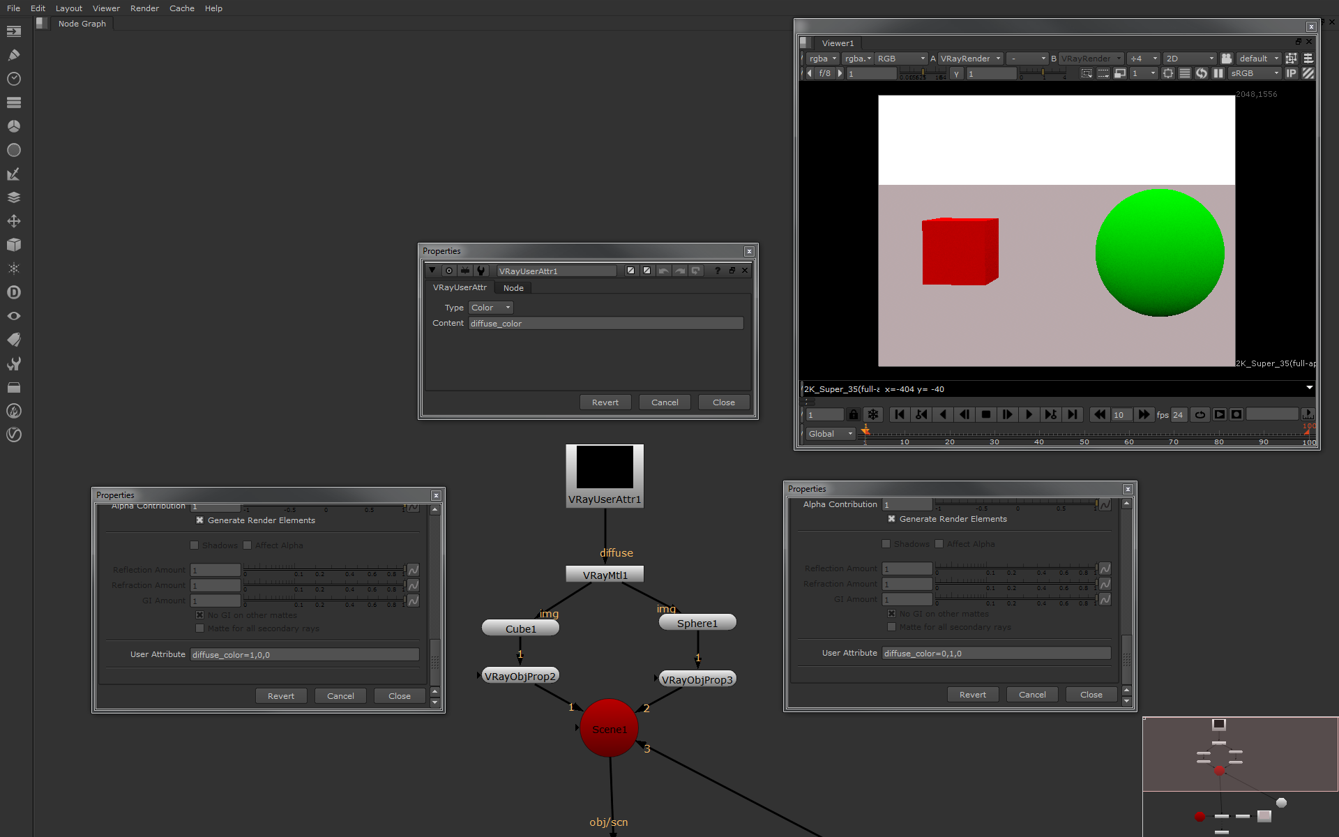

Below is a sample node graph with the necessary settings of the nodes in order to use the VRayUserAttr node to control the diffuse color of a VRayMtl node.
In the example we have two objects in the scene - a sphere and a cube. Both objects have the same VRayMtl node applied as a material. We are using a VRayUserAttr node connected to the diffuse slot of our VRayMtl, the Type is set to Color and the Content is set to "diffuse_color". Each of our geometry nodes passes through a VRayObjProp node. This allows us to assign a specific User Attribute to each geometry. In our case we are assigning a User Attribute of "diffuse_color=1,0,0" to the Cube and a User Attribute of "diffuse_color=0,1,0". When the rendering begins V-Ray is trying to determine the diffuse color of each object. The diffuse color is specified by the "diffuse_color" user attribute which in the case of the Cube is set to 1,0,0. Because the Type of the VRayUserAttr node was set to Color, the 1,0,0 value is translated into RGB which translates to the red color you see in the rendering.
The same approach can be used to control any parameter that requires a numerical value, with the only difference that the Type of the VRayUserAttr should be set to Scalar.
