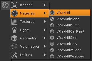

UI Path: ||Toolbar|| > V-Ray menu icon > Materials > VRayMtl

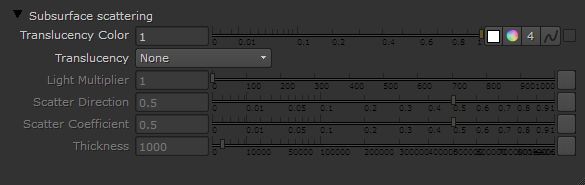

Translucency Color

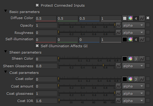

Main Parameters Tab
Diffuse Color – The diffuse color of the material. Note: the actual diffuse color of the surface also depends on the reflection and refraction colors.
Opacity – Allows the user to assign opacity to the material where white is completely opaque and black is completely transparent. This way you can create a material that has a non-uniform opacity.
Roughness – Used to simulate rough surfaces or surfaces covered with dust (for example, skin, or the surface of the Moon).
Self-Illumination – Controls the emission of the surface.
Self-Illumination Affects GI – When enabled, the self-illumination affects global illumination rays and allows the surface to cast light on nearby objects. Note: It may be more efficient to use area lights for this effect.

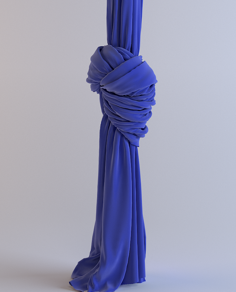

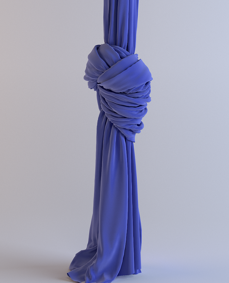

The Sheen layer can be used for creation of cloth material, such as satin.
Sheen Color – Specifies the color.
Sheen Glossiness – Controls the sharpness of reflections. A value of 1.0 means all of the light reaches the diffuse color, and when the value is smaller, the cloth material looks glossier. See the Sheen Glossiness parameter below for more information.
Example: Sheen Glossiness
This example shows how changing the glossiness parameter of the sheen layer affects the material. A smaller value makes the sheen layer reflect most of the light. Increasing the value allows more light to reach the diffuse component.
Glossiness = 0.1
Glossiness = 0.3
Glossiness = 0.6
Glossiness = 0.8
Glossiness = 0.9
0.1
0.9

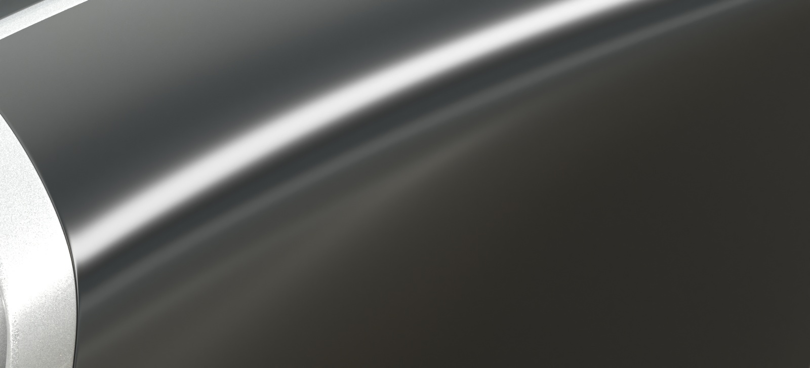

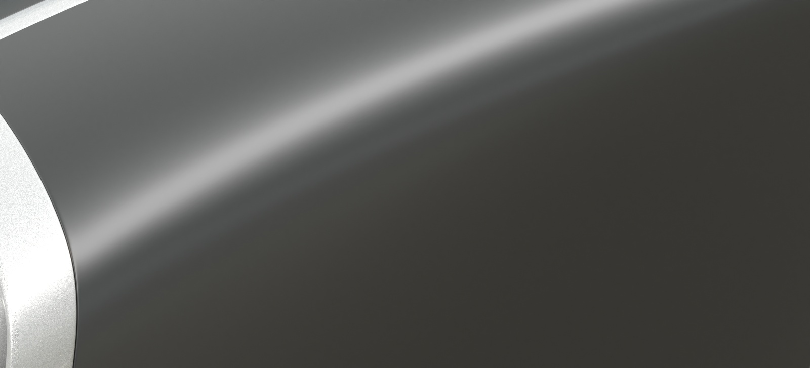

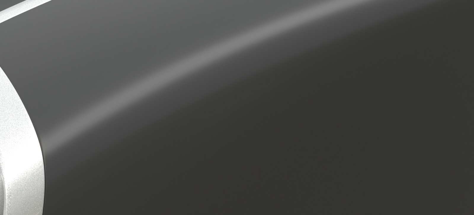

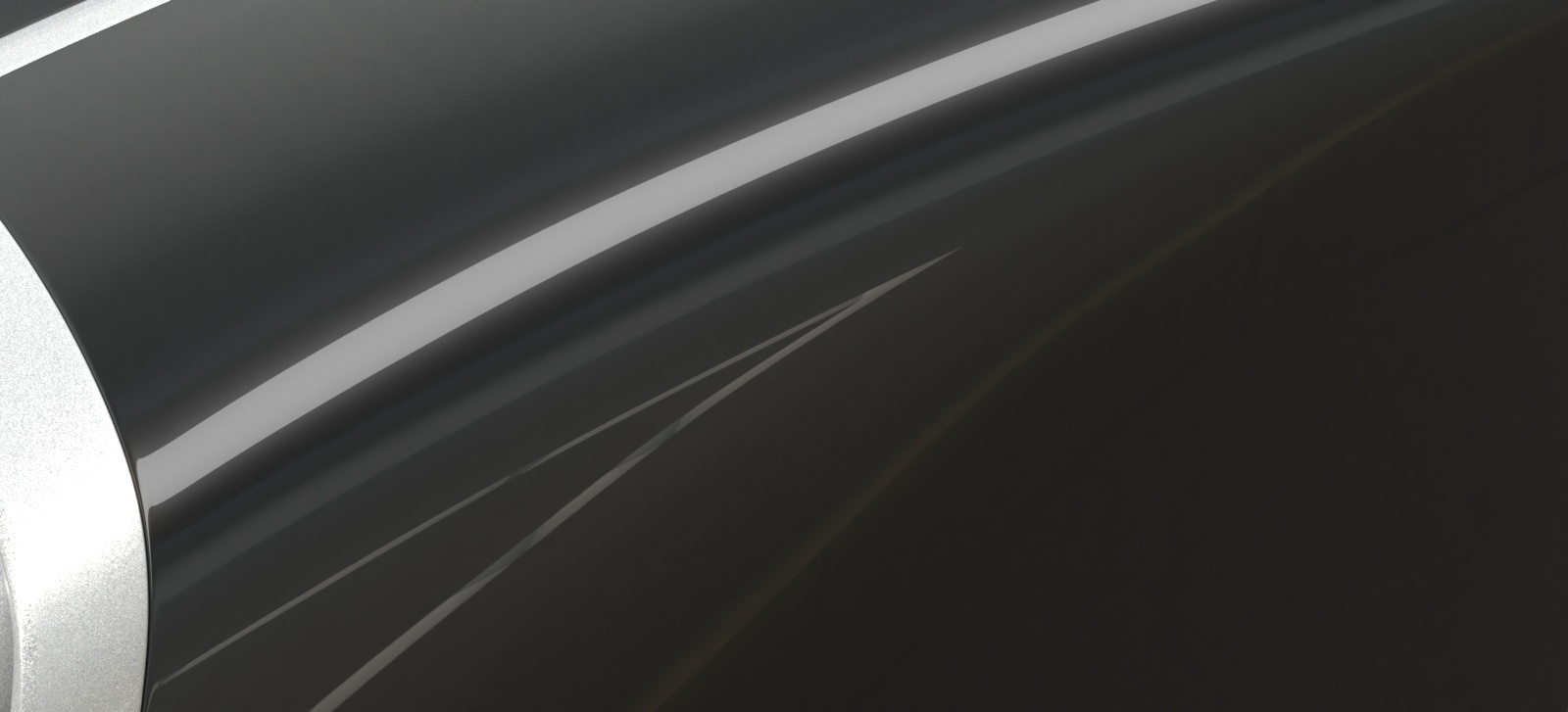

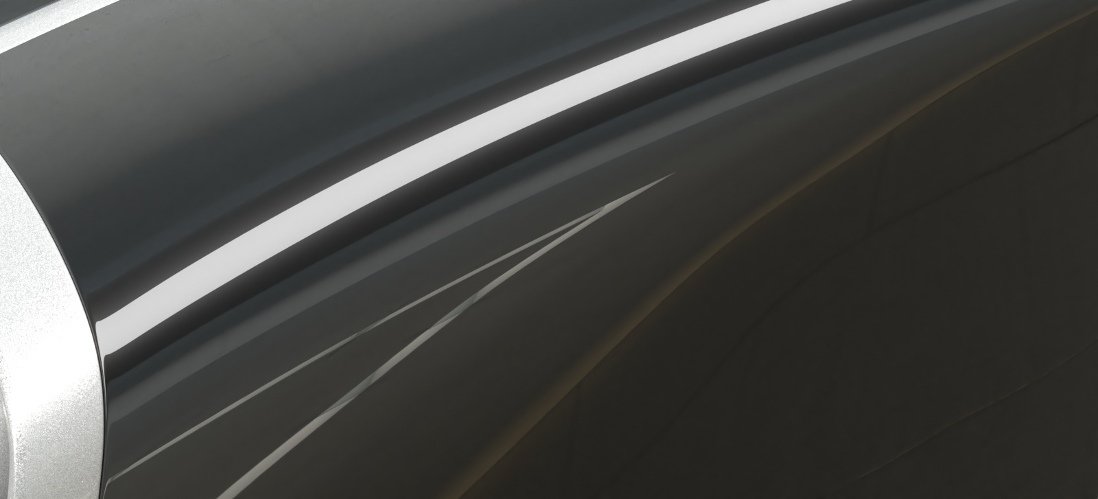

Coat Color – Determines the coat layer's color. A texture map can be used here.
Coat amount – Specifies the blending weight of the coat layer. A value of 0 does not add a coat layer, while higher values blend the coat gradually. See the Coat Amount example below for more information.
Coat glossiness – Controls the sharpness of reflection. A value of 1.0 means perfect glass-like reflection; lower values produce blurry or glossy reflections. See the Coat Glossiness example below for more information.
IOR – Specifies the Index of Refraction for the coat layer.
Example: Coat Amount
This example shows how the Amount value affects the look of the material. The base Reflection Glossiness is 0.76 and the Coat glossiness is set to 0.985. IOR is 2.2 and the Coat Color is the default white.
Example: Coat Glossiness
Coat glossiness controls the sharpness of the coat reflection. In this example, the base Reflection Glossiness is set to 0.76 and the Coat Amount is set to 1. IOR is 2.2 and the Coat Color is the default white. Notice how higher values produce glossier reflection and lower values make it look blurry.

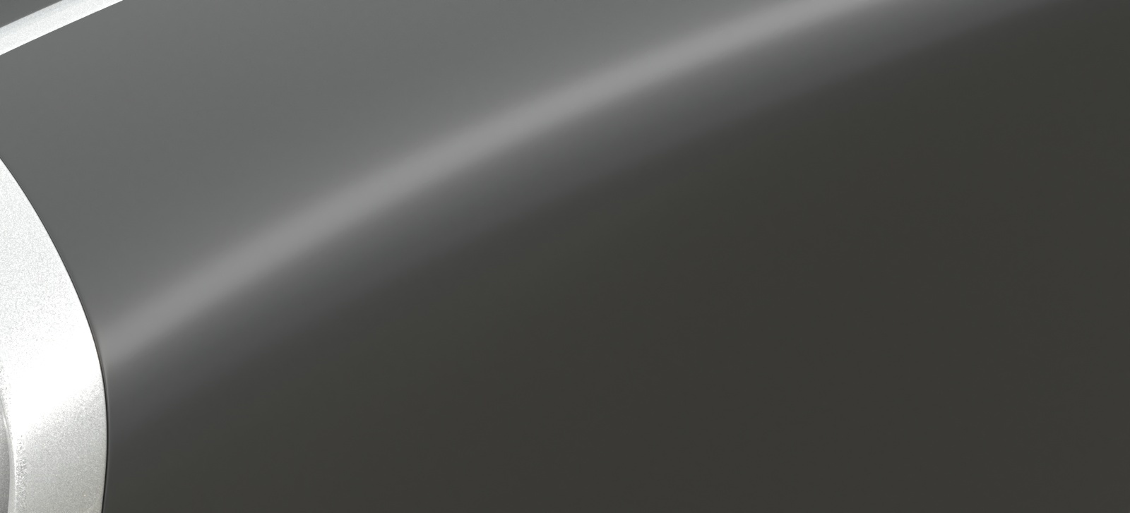

The BRDF parameter determines the type of the highlights and glossy reflections for the material. This parameter has an effect only if the reflection color is different from black and reflection glossiness is different from 1.0.
BRDF Type – Determines the type of BRDF (the shape of the highlight). For more information, see The BRDF Type example below.
Phong – Phong highlight/reflections.
Blinn – Blinn highlight/reflections.
Ward – Ward highlight/reflections.
GGX – GGX highlight/reflections.
GGX is the most modern and flexible BRDF(Bidirectional reflectance distribution function) type and is able to better represent a broad range of materials thanks to its ability to control the shape of the specular lobe.
There currently isn't any particular performance difference between models and there is little reason to choose any of the other types.
Historically, the Phong, Blinn, Ward and GGX are successive reflectance models developed over the years in computer graphics where each model aimed to improve on the limitations of the previous ones. For example, the specular highlights with the Phong model have a very narrow and bright center with no falloff, but it doesn't work well with anisotropic reflections. The Blinn model has broader highlight center with a tight falloff. The Ward model has an even broader center and falloff. The GGX model has a bright center and an even longer falloff (at default settings). In the past, each model's characteristics resembled more closely a certain type of material, for example Phong could be used for plastics, Ward for cloth and metals, and Blinn for other common surfaces. However with the introduction of the GGX model, all of these surfaces can be approximated well, thus reducing the need for using the other models.
It should be noted that no principled model is able to represent all possible materials entirely accurately, and where those models fail - for example when the material isn’t viewed frontally - only approaches such as that of VRscans are able to capture the correct material representation.

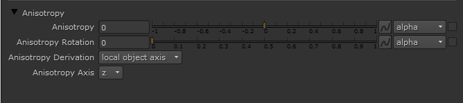

Anisotropy Rollout
Anisotropy – Determines the shape of the highlight. A value of 0.0 means isotropic highlights. Negative and positive values simulate "brushed" surfaces. For more details, please see The Anisotropy Parameter example below.
Rotation – Determines the orientation of the anisotropic effect in a float value between 0 and 1 (where 0 is 0 degrees and 1 is 360 degrees).
Anisotropy Derivation – Specifies the method to use for deriving anisotropy axes.
local object axis – Uses the Anisotropy Axis parameter to determine Anisotropy Derivation.
uvw generator – Generates Anisotropy Derivation based on UVW.
Anisotropy Axis – Choose the local object axis to use when anisotropy_derivation is set to local object axis.

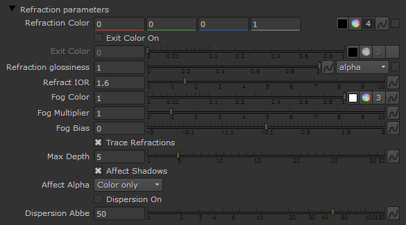

Refraction Parameters Tab
Refraction Color – Refraction color. Note that the actual refraction color depends on the reflection color as well. For more information, see The Refraction Color Parameter example below.
Exit Color On – If this is on, and a ray has reached the maximum refraction depth, the ray will be terminated and the Refraction Exit Color value returned. When this is off, the ray will not be refracted but will be continued without changes.
Exit Color – If a ray has reached its maximum depth this color will be returned instead of tracing the ray further.
Refraction glossiness – Controls the sharpness of refractions. A value of 1.0 means perfect glass-like refraction; lower values produce blurry or glossy refractions. For more information, see The Refraction Glossiness Parameter example below.
Refract IOR – Index of refraction for the material, which describes the way light bends when crossing the material surface. A value of 1.0 means the light will not change direction. For more information, see The Refraction IOR Parameter example below.
Fog Color – The attenuation of light as it passes through the material. This option helps simulate the fact that thick objects look less transparent than thin objects. Note that the effect of the fog color depends on the absolute size of the objects and is therefore scene-dependent. For more information, see The Fog Color Parameter example below.
Fog Multiplier – The strength of the fog effect. Smaller values reduce the effect of the fog, making the material more transparent. Larger values increase the fog effect, making the material more opaque. For more information, see the Fog Color Parameter example below.
Fog Bias – Changes the way the fog color is applied. Negative values make the thin parts of the objects more transparent and the thicker parts more opaque and vice-versa (positive numbers make thinner parts more opaque and thicker parts more transparent).
Trace Refractions – Check to enable refractions for the current material.
Max Depth – The number of times a ray can be refracted. Scenes with lots of refractive and reflective surfaces may require higher values to look correct.
Affect Shadows – Causes the material to cast transparent shadows to create a simple caustic effect dependent on the refraction color and the fog color. For accurate caustic calculations, disable this parameter and instead enable Caustics in the GI rollout of the VrayRenderer node. Simultaneous usage of both Caustics and Affects Shadows can be used for artistic purposes but will not produce a physically correct result.
Affect Alpha – Allows you to specify which channels are going to be affected by the transparency of the material.
Color Only – The transparency will affect only the RGB channel of the final render.
Color+alpha – This will cause the material to transmit the alpha of the refracted objects, instead of displaying an opaque alpha. Note that currently, this works only with clear (non-glossy) refractions.
All channels – All channels and render elements will be affected by the transparency of the material.
Dispersion On – Enables the calculation of true light wavelength dispersion.
Dispersion Abbe – Allows you to increase or decrease the dispersion effect. Lowering it widens the dispersion and vice versa.
Example: The Refraction Color Parameter
This example demonstrates the effect of the Refraction color parameter to produce glass materials. For the images in this example, the material is with a gray Diffuse color, white Reflection color and Fresnel option on.
Refraction color is black (0, 0, 0) (no refraction)
Refraction color is light gray (192, 192, 192)
Refraction color is white (255, 255, 255)
Example: The Refraction Glossiness Parameter
This example demonstrates the effect of the Refraction glossiness parameter. Note how lower Refraction glossiness values blur the refractions and cause the material to appear as frosted glass.
Refraction glossiness is 1.0
Refraction glossiness is 0.9
Refraction glossiness is 0.8
Example: The Refraction IOR Parameter
This example demonstrates the effect of the Refraction IOR parameter. Note how light bends more as the IOR deviates from 1.0. The case when the index of refraction (IOR) is 1.0 produces a transparent object. Note, however, that in the case of transparent objects, it might be better to assign an opacity map to the material, rather than use refraction.
Refraction IOR is 0.8
Refraction IOR is 1.0
Refraction IOR is 1.3
Refraction IOR is 1.8
Example: The Fog Color Parameter
This example demonstrates the effect of the Fog color parameter. Notice how the thick areas of the object are darker in the two images on the right because of the light absorption of the fog.
Fog color is white (255, 255, 255) (no light absorption)
Fog color is gray (128, 128, 128)
Fog color is green (116, 190, 102)
Example: The Fog Multiplier Parameter
This example demonstrates the effect of the Fog multiplier parameter. Smaller values cause less light absorption because of the fog; while higher values increase the absorption effect.
Fog multiplier is 0.5
Fog multiplier is 1.0
Fog multiplier is 1.5
Subsurface scattering Rollout
Translucency Color – Normally the color of the sub-surface scattering effect depends on the Fog color; this parameter allows you to additionally tint the SSS effect.
Translucency – Selects the algorithm for calculating translucency (also called sub-surface scattering). Note that refraction must be enabled for this effect to be visible. Currently, only single-bounce scattering is supported. The possible values are:
None – No translucency is calculated for the material;
Hard (wax) model – This model is specifically suited for hard materials like marble;
Soft (water) model – This model is mostly for compatibility with older V-Ray versions (1.09.x);
Hybrid model – This is the most realistic sss model and is suitable for simulating skin, milk, fruit juice and other translucent materials.
Light Multiplier – A multiplier for the translucent effect.
Scatter Direction – Controls the direction of scattering for a ray. 0.0 means a ray can only go forward (away from the surface, inside the object); 0.5 means that a ray has an equal chance of going forward or backward; 1.0 means a ray will be scattered backward (towards the surface, to the outside of the object).
Scatter Coefficient – The amount of scattering inside the object. 0.0 means rays will be scattered in all directions; 1.0 means a ray cannot change its direction inside the sub-surface volume.
Thickness – Limits the rays that will be traced below the surface. This is useful if you do not want or do not need to trace the whole sub-surface volume.
