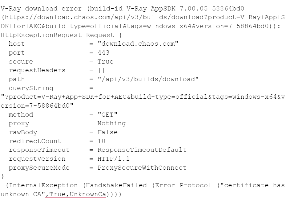

The main way to distribute the required V-Ray version to a Swarm peer's machine is the automatic Download. It is possible to receive a Download Failed error. This error can be caused by an old Windows version or missing OS certificates. Here are several ways to resolve it.

You can download the V-Ray version manually from this pageTo determine the correct V-Ray version, you need the Error URL. It can be obtained from the Web Ui error tooltip or from the Swarm log files.
Example: https://download.chaos.com/api/v3/builds/download?product=V-Ray+App+SDK+for+AEC&build-type=official&tags=windows-x64&version=7-58864bd0
