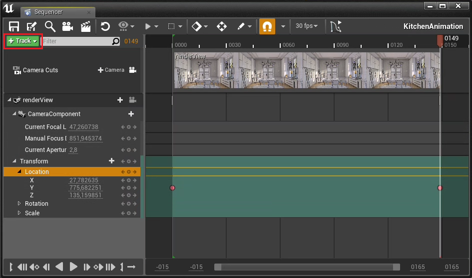

First, create a level sequence.
This could be done from Cinematics > Add Level Sequence. Select the folder where the animation sequence will be saved.
Now, you have to add a camera actor from level to the sequence.
Go to Sequencer > + Track > Actor to Sequencer and select the camera actor.
Adjust the settings of the camera to your liking.
You can add keys to store the changes in the animation dynamics.

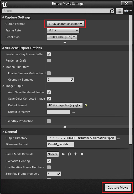

Step 2: Export with V-Ray
Once ready with the settings configuration, go to Render Movie Settings.
From the Capture Settings panel > Output Format select the V-Ray animation export option.
Now, set the VRScene export options. In this example, we want to autosave the rendered frame, and for the purpose of the tutorial - show it in the V-Ray Frame Buffer.
Select the appropriate image output format.
You can double check if the Output Directory shows the right path. When Render in VRay Frame Buffer and Auto Save Rendered Frame are set to true a .vrscene  file with the name specified in Filename Format will be generated. If Output Directory in VRScene Export Options is empty then the frames will be saved in the directory of the .vrscene.
Press the Capture Movie button to begin the export.
