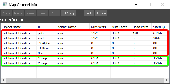

In 3Ds Max, you can select an object and check its UV channel from Tools > Channel Info.
Note that there are channels created by default (marked in red) and channels that you create marked in green.
V-Ray for Unreal uses the last map channel in the light baking process. Thus, it is important to ensure the last UV channel is set properly. If necessary, create a new channel dedicated specifically for the light map that will be used in the light bake.

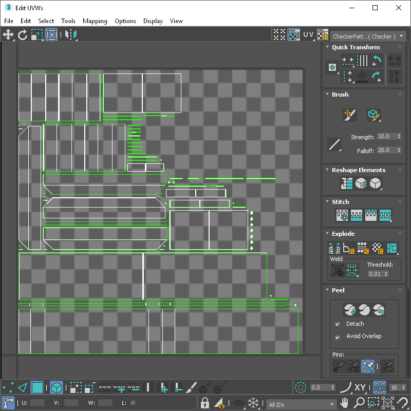

We have to first check the last available UV channel for problematic UVs such as:
  • Overlapping UVs
  • UVs that go outside the 0 - 1 UV space range
If the channel does not contain any of the forementioned issues then this static mesh is suitable for light baking.

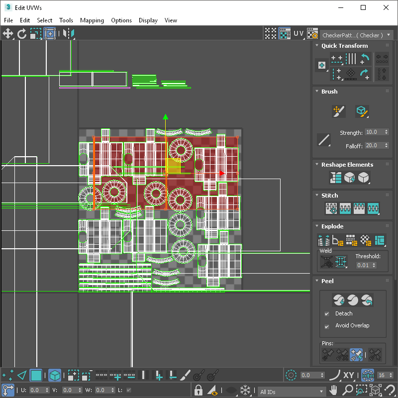

Step 3: Creating new UVs
If, however, overlapping and/or out the 0-1space range UVs are present then you should create a new UV channel that will be used for the light maps. In the new channel create clean UVs. Do the same procedure for all objects in the scene to ensure a smooth light baking process.
