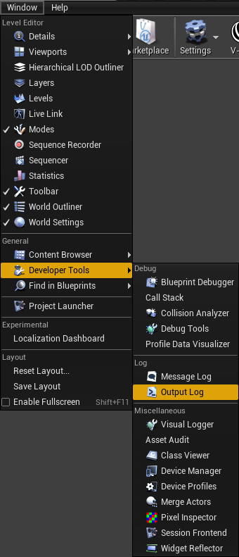

All processes and events that are executing in Unreal are exported in the Output and Message Logs. From the Output log you can filter the shown information via the Categories flags.
UI Paths
||Window|| > Developer Tools > Output Log
 Click here to expand for a screenshot...
||Window|| > Developer Tools > Message Log
