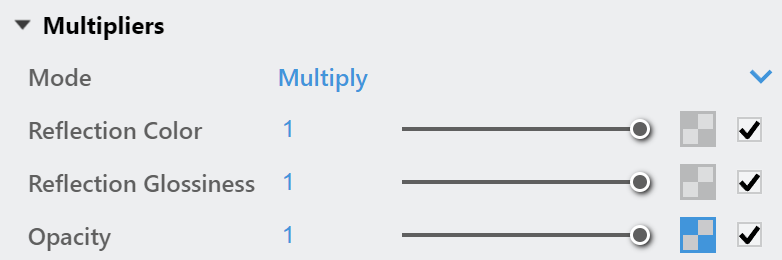

Multipliers
Mode – Specifies how textures and colors will be blended by the multipliers.
Multiply – The texture is blended with a black color.
Blend Amount – The user-specified color is used for blending
Reflection Color – Controls the intensity of the reflection color.
Reflection Glossiness – Controls the intensity of the reflection sharpness.
Opacity – Controls the intensity of the overall material Opacity.
