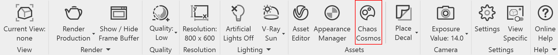

UI path
||Revit Ribbon|| > V-Ray tab > Assets panel > Chaos Cosmos
