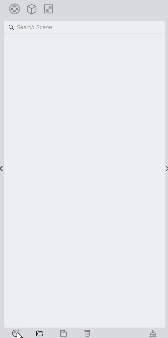

A UVW Placement texture can be created as any other texture from the Create Asset button (Create button > Textures > UVW Placement) and the Texture category icon (Right-Click on the category).

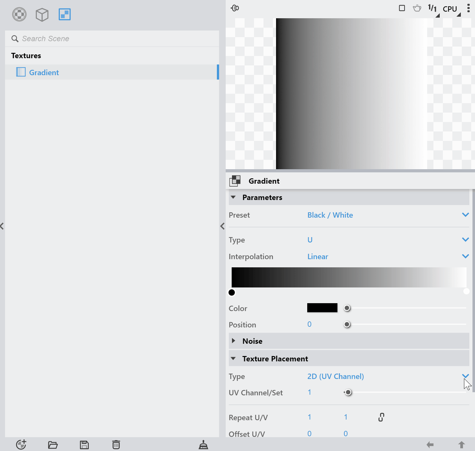

Alternatively, you can set a texture's Placement Type to Mapping Source and then click on the UV Placement Source icon and selecting UVW Placement.

2D (UV Channel) – The texture uses the object UV coordinates.

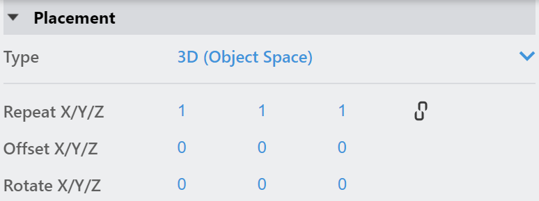

3D (Object Space) – Places the texture based on the local object coordinates independent of the object UVs.

Repeat X/Y/Z – Determines how many times the texture is repeated along the X/Y/Z axis.
Lock U/V Repeat – Locks the X/Y/Z repeat.
Offset X/Y/Z – Controls the texture offset in the X/Y/Z direction.
Rotate X/Y/Z – Rotates the texture around the X/Y/Z axis.
