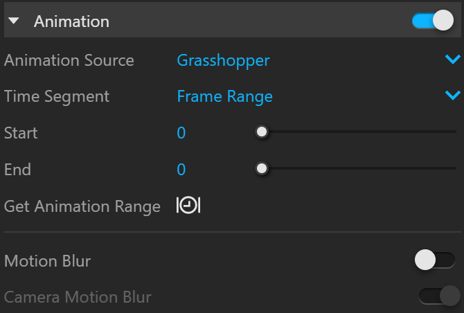

From the Animation rollout, you can set a frame range for animated scenes. If no animation has been set up in Rhino, the toggle of this section remains grayed out indicating that there is nothing animated in the current scene. You can also apply Motion Blur here.

UI Path
||V-Ray Asset Editor|| > Settings > Animation rollout
Animation – Enables the rendering of animated sequences.
Animation Source – Allows switching between animations recorded using the Rhino Animation tools and Sun or Camera Animation imported from Grasshopper via the V-Ray Render in Project component. Note that starting from V-Ray for Rhino v4.20.01 onward, animation exported from Grasshopper to Rhino will not be preserved in the Rhino project (.3dm) file. It will be available during the active session but if closed and reopened the animation will need to be reimported from the Grasshopper (.gh) file via the V-Ray Render in Project component.
Rhino – Selects the animation recorded using Rhino Animation tools.
Grasshopper – Selects the Sun/Camera Animation imported from Grasshopper via the V-Ray Render in Project component.
Time Segment – Specifies whether the entire animation or only a subset are rendered as individual frames.
Entire Animation – Renders the entire animation as individual frames.
Frame Range – Allows selection of only certain frames to be rendered.
Start – Allows rendering a subset of the animation as opposed to rendering the entire sequence. Value is expressed in "frames". Available when Time Segment is set to Frame Range.
End – Allows rendering a subset of the animation as opposed to rendering the entire sequence. Value is expressed in "frames". Available when Time Segment is set to Frame Range.
Get Animation Range – Sets the frame-range to match the current project animation length. Available when Time Segment is set to Frame Range.
Motion Blur – Turns on motion blur sampling.
Camera Motion Blur – When enabled, it considers the camera movement when calculating the motion blur effect. Otherwise, only objects in motion are blurred. Note that only proxy scene or mesh references can introduce object animation.
