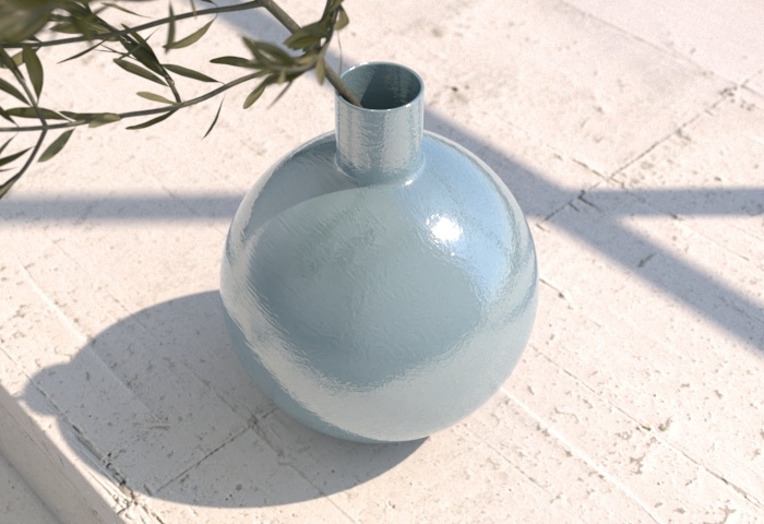

The Coat rollout is part of the Generic material's parameters.
See the Coat and Sheen Layers page or the Courseware page for more information.

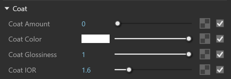

Coat
Coat Amount* – Specifies the blending weight of the coat layer. A value of 0 does not add a coat layer, while higher values blend the coat gradually. See the Coat Amount example below.
Coat ColorDetermines the coat layer's color. A texture map can be used here.
Coat Glossiness* – Available when the Surface control option is set to Use Glossiness. Controls the sharpness of reflection. A value of 1.0 means perfect glass-like reflection; lower values produce blurry or glossy reflections. See the Coat Glossiness example below.
Coat IOR*Specifies the Index of Refraction for the coat layer.

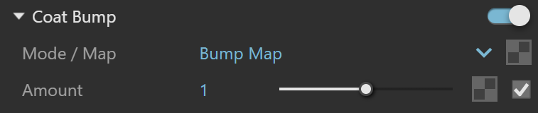

Coat Bump
Mode / Map – Allows the user to specify whether a bump map or a normal map effect is added to the base material.
Bump Map* – Requires a height map.
Normal Map – Requires an RGB map. If a Bitmap texture is slotted, its color space must be set to Rendering Space (Linear).
Local Space BumpA height map should be used. Unlike the standard Bump mode, in this case the height is not measured in scene units. It is only determined by the raw texture values. Scaling objects will not affect the local space effect. This option has to be selected for the round edges effect (Edges texture used as bump).
Amount* – Multiplies the Bump / Normal effect.

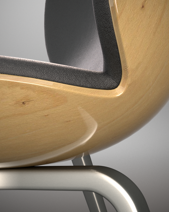

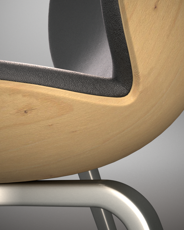

Example: Coat Amount
This example shows how Coat Amount affects the look of the material. The base Reflection Glossiness is set to 0.76 and the Coat Glossiness is set to 1. The value of the Coat IOR is set to 2 and the Coat Color is the default white.
Coat Amount = 0
Coat Amount = 0.25
Coat Amount = 0.5
Coat Amount = 0.75
Coat Amount = 1

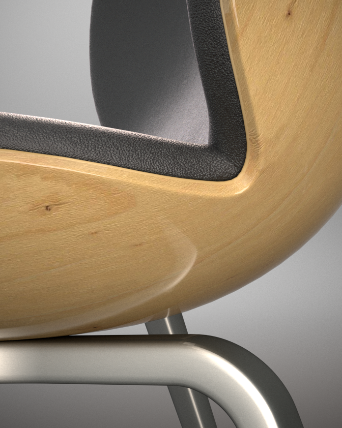

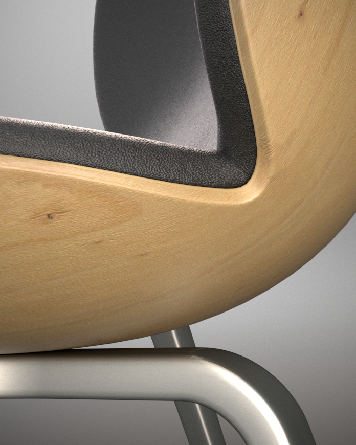

Example: Coat Glossiness
This examples shows how Coat Glossiness controls the sharpness of the coat reflection. Here, the base Reflection Glossiness is set to 0.76 and the Coat Amount is set to 1. Coat IOR is 2 and the Coat Color is the default white.
Notice how higher values produce glossier reflection and lower values make it look blurry.
Coat Glossiness = 0
Coat Glossiness = 0.25
Coat Glossiness = 0.5
Coat Glossiness = 0.75
Coat Glossiness = 1
