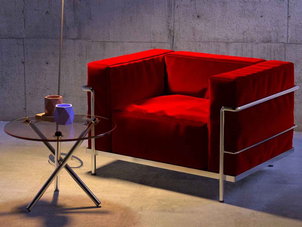

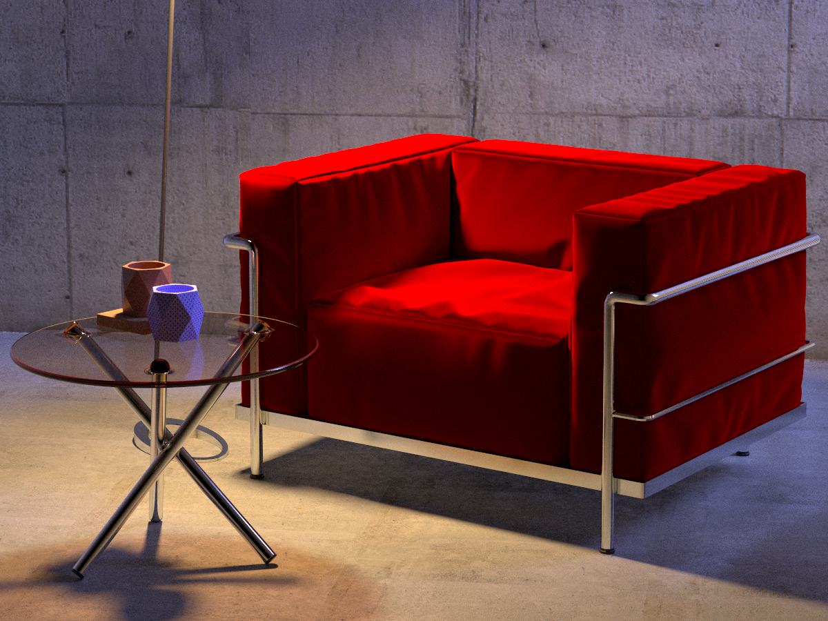

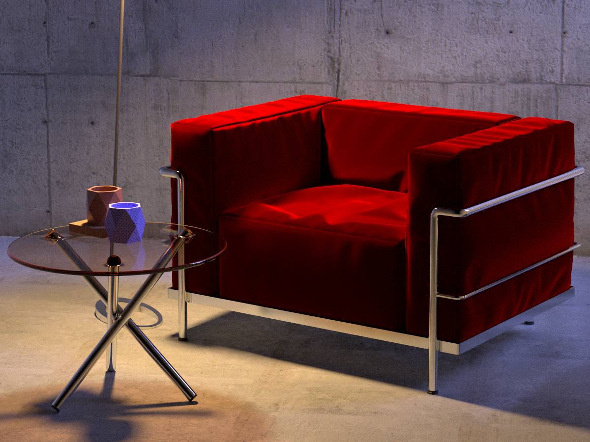

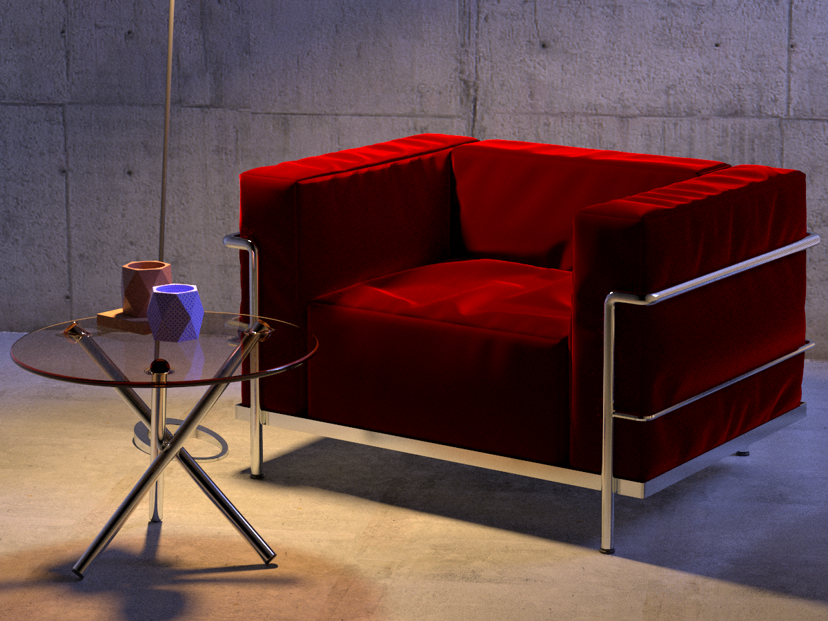

Example: Sheen Glossiness
This example shows how changing the glossiness parameter of the sheen layer affects the material. A smaller value makes the sheen layer reflect most of the light. Increasing the value allows more light to reach the diffuse component.
Sheen Reflection = 0.1
Sheen Reflection = 0.3
Sheen Reflection = 0.5
Sheen Reflection = 0.6
Sheen Reflection = 0.8
Sheen Reflection = 0.9
Sheen Reflection = 1
