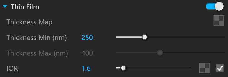

The Thin Film rollout is part of the Generic material's parameters.
The Thin Film recreates the effect of thin film interference on a surface making the material iridescent. Some common uses are soap bubbles and reflective car paint layering.
Thin Film
Available only in Advanced mode.
Thin Film – Turns on/off the thin film effect.
Thickness Map – Specifies the thickness texture. The map blends between the Min and Max thickness values and is expected to be in the range of 0-1. If there is no texture map, only the minimum thickness value is used.
Thickness Min (nm) – Determines the minimum thickness measured in nanometers. See the Thin Film Thickness example for more information.
Thickness Max (nm) – Determines the maximum thickness measured in nanometers.
IOR – Specifies the index of refraction of the medium the thin film is made of.
