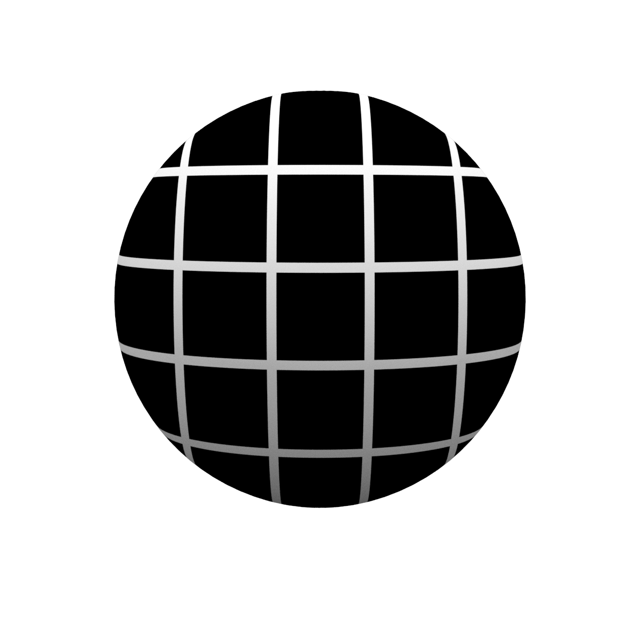

The V-Ray Grid texture map generates a procedural grid texture.

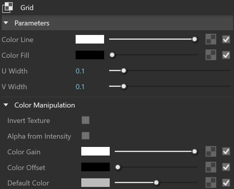

Color Line – Specifies the grid line's color or texture. When a texture is selected, it overrides the color as long as the texture checkbox is enabled.
Color Fill – Specifies the grid fill's color or texture. When a texture is selected, it overrides the color as long as the texture checkbox is enabled.
U Width – Controls the horizontal line width.
V Width – Controls the vertical line width. For more information, see the U Width and V Width example below.
Color Manipulation
Invert Texture – Inverts the RGB texture values.
Alpha from Intensity – Uses the texture RGB intensity/ luminance as alpha channel.
Color Gain – Corrects the color of the texture by multiplying the RGB color values in the texture with the RGB color values specified here. A texture map can be assigned here.
Color Offset – Corrects the color of the texture by adding the RGB color values specified here to the RGB color values of the texture. A texture map can be assigned here.
Default Color – Specifies a default color used for polygons with no valid UVs. In case the map is not tiled, specifies a default color that is used outside the texture square.

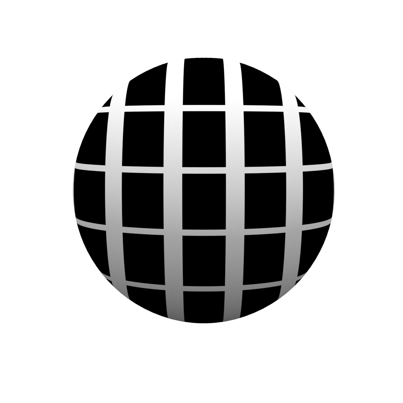

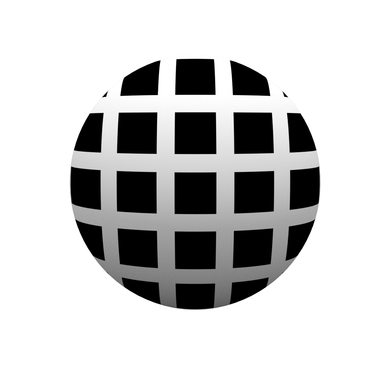

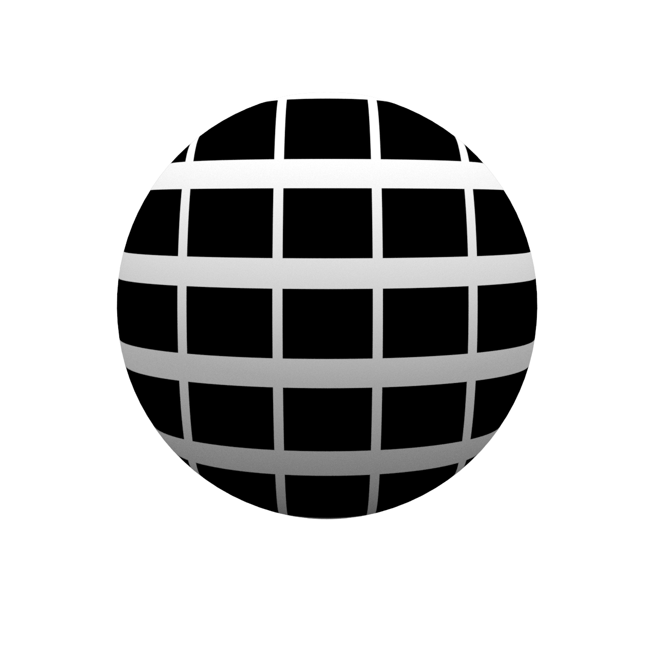

Example: U Width and V Width
U Width:
1
V Width:
1
U Width:
1
V Width:
3
U Width:
3
V Width: 1
U Width:
3
V Width: 3

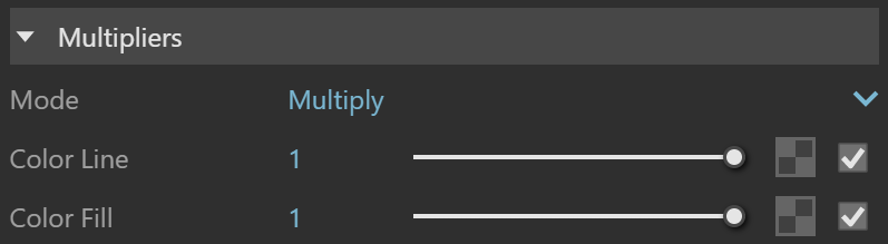

Multipliers
Mode – Specifies the multiplication mode of the colors.
Multiply – The color used for blending is black.
Blend Amount   The color used for blending is the one specified in the color slot.
Color Line – Specifies blends between a color and a texture, if specified.
Color Fill – Specifies blends between a color and a texture, if specified.
