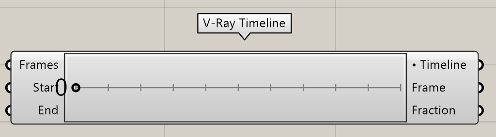

Input Parameters
Frames (Integer) – Number of timeline frames. Controls the animation length.
Start (Integer) – Specifies the first frame from a range of frames to be rendered. Its value cannot exceed the value of the Range End input parameter.
End (Integer) – Specifies the last frame from a range of frames to be rendered. It cannot exceed the last frame number of the total animation.
Output Parameters
Timeline (Generic Data) – V-Ray Timeline output. It can be connected to the V-Ray Render or Timeline slot.
Frame (Integer) – Outputs the current animation frame as an integer value. This output can be used for animating different definition parameters.
Fraction (Number) – Outputs the current animation frame as a fraction of the slider length - a value in the range 0.0 to 1.0 (inclusive). For example, if the timeline frames count is set to 11 and the slider position is at 5, the fraction float output will be 0.5 This output can be used for animating different definition parameters.

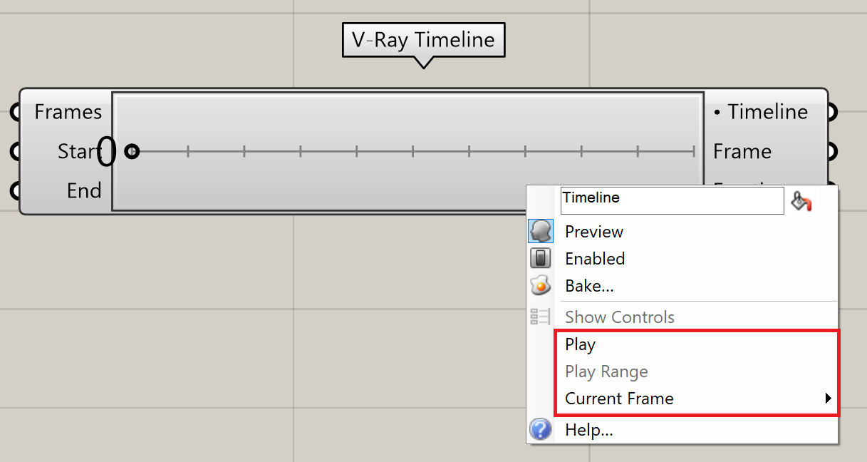

Right-click on the component to see more options.
