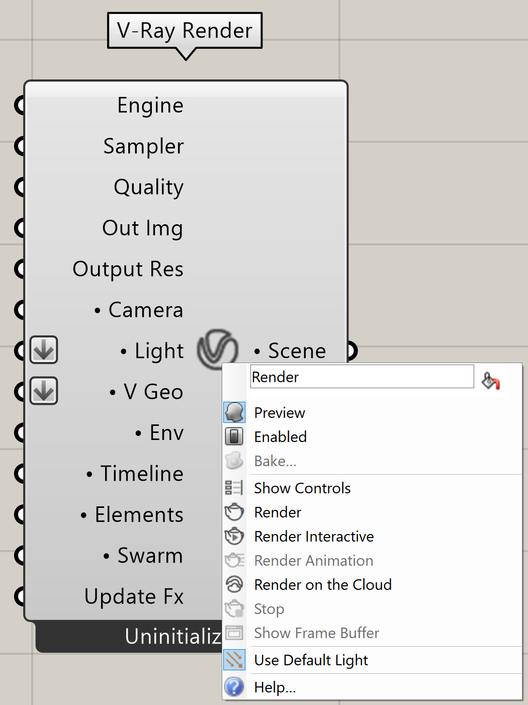

Context Menu
Right-click on the V-Ray Render component to open.
Render – Starts the rendering process.
Render Interactive – Starts Interactive rendering.
Render Animation – Renders animation.
Render on the Cloud – Automatically exports a .vrscene and submits it to Chaos Cloud for rendering. Note that animations are always included when present.
Stop –  Stops the rendering process.
Show Frame Buffer – Shows the V-Ray Frame Buffer.
Use default light – Adds a directional light with default parameter values if no other light exists in the scene.
Right-click on the component to see more options.
