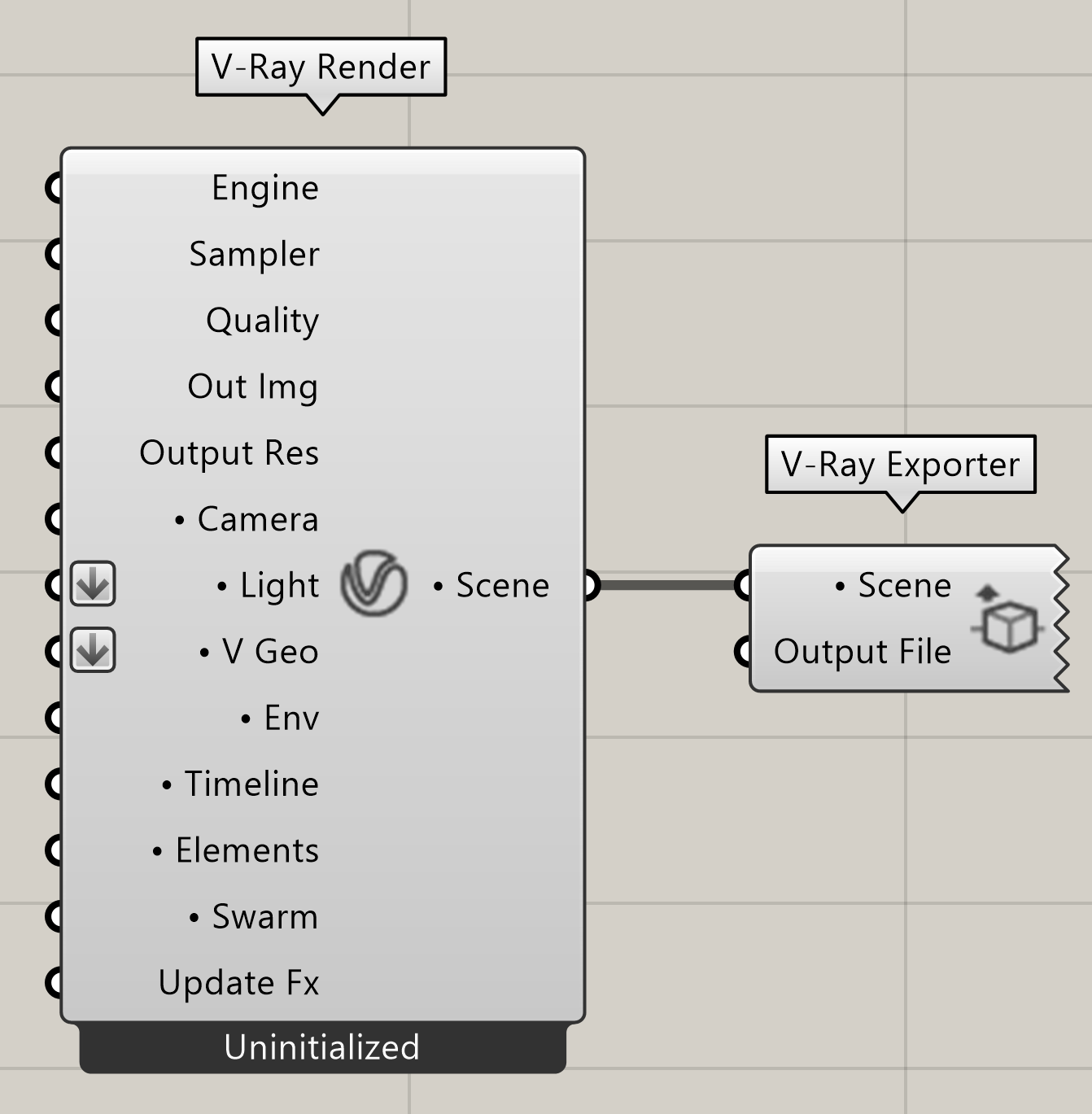

The V-Ray Exporter component exports the current scene to a .vrscene or .vrmesh file. The component must be connected to a V-Ray Render component and a valid output file must be set.

Show Controls - Provides an output file component connected to the exporter. Specifying a valid output file is required for the V-Ray Exporter to work.

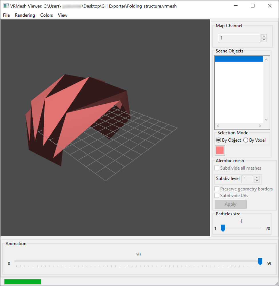

 Export – Exports a Proxy Mesh (.vrmesh) or a V-Ray Scene (.vrscene).
Export Animation - Exports an animation as a single animated Proxy Mesh or V-Ray Scene file. This function is disabled when there is no animation in the scene.

Note that .vrmesh files do not store lights, camera, render settings, or material data. They contain only geometry data and face IDs.
If there is a Timeline connected to the V-Ray Render component, the Export option produces a file based on the current frame while the Export Animation includes the entire Timeline animation.

Scene (Generic Data) – This is the scene input slot. A V-Ray Render's Scene is expected here.
Output File (Text) – Specifies the output file location and type. Select .vrscene for a scene export and .vrmesh for a proxy mesh export.

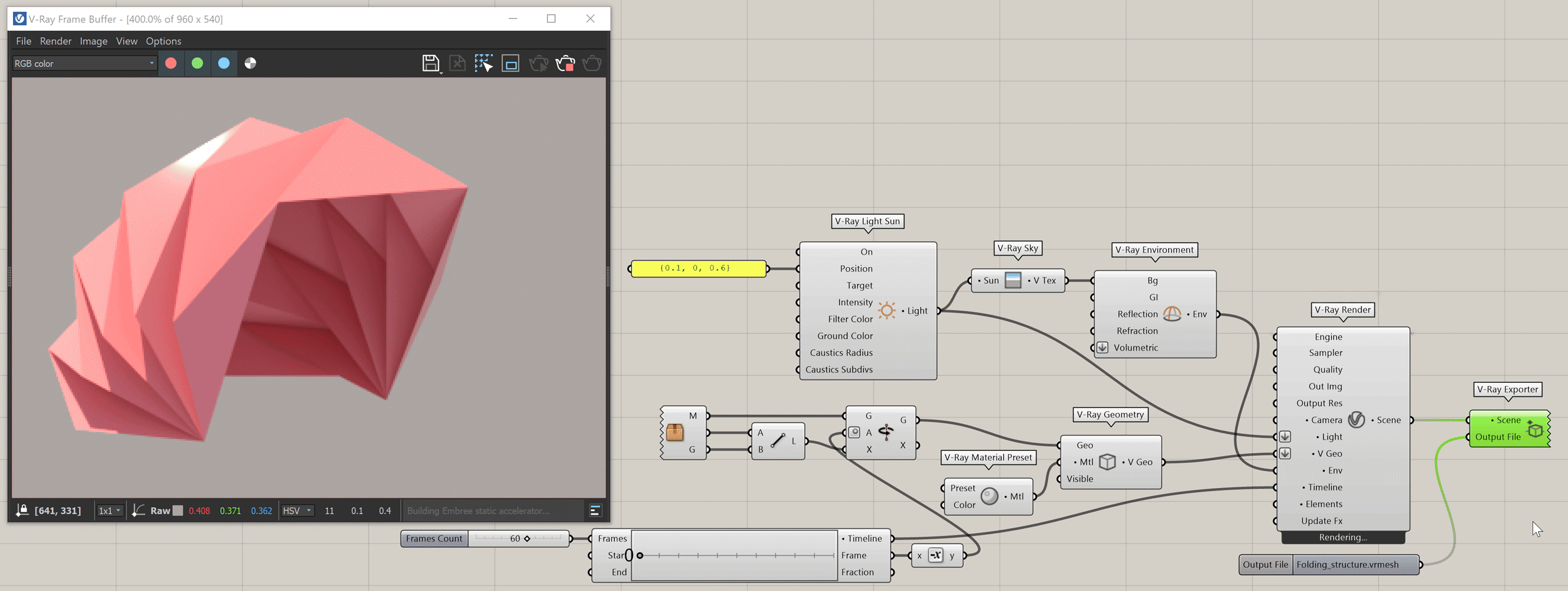

Example:
Download the GH definition here.
