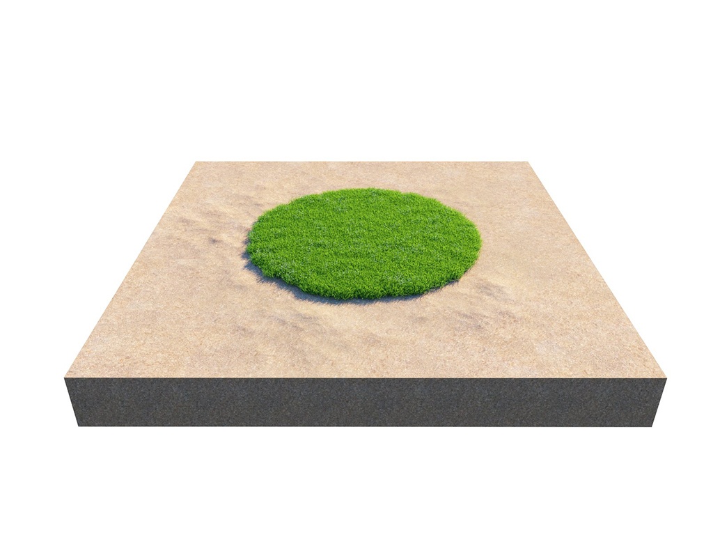

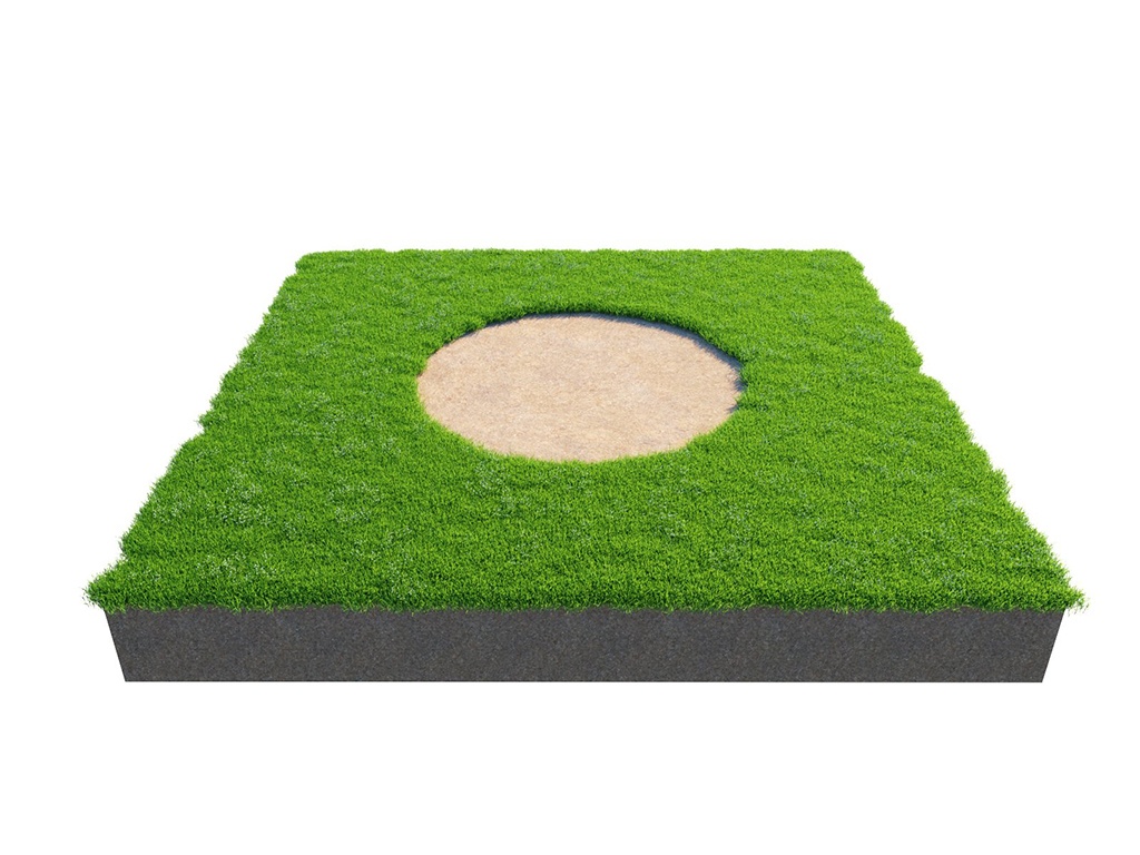

Example: Operation
This example shows the difference between the Include and Exclude Operation modes.

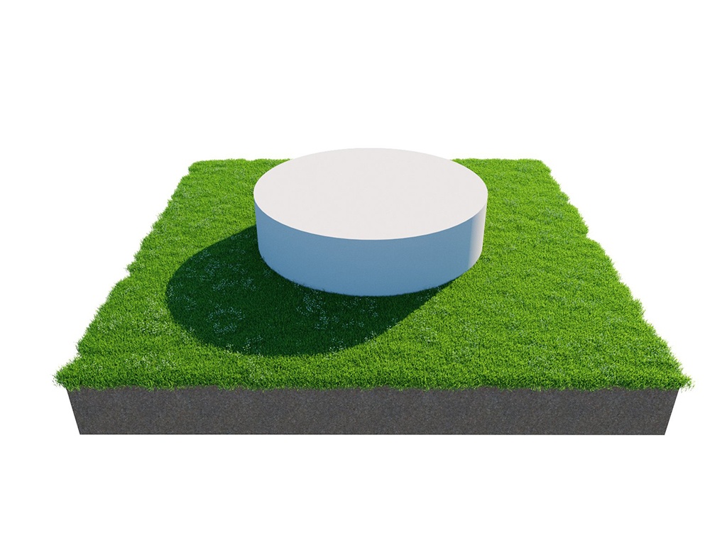

Example: Axis
This example shows the modifier projection plane.
01_AreaModifiers_Modifier_Cyl
Modifier = Cylinder
02_AreaModifiers_Cyl_Operation_Include
Modifier = Cylinder; Operation = Include
03_AreaModifiers_Cyl_Operation_Exclude
Modifier = Cylinder; Operation = Exclude

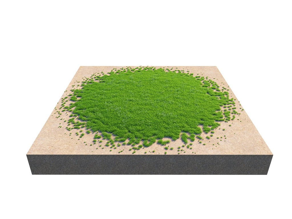

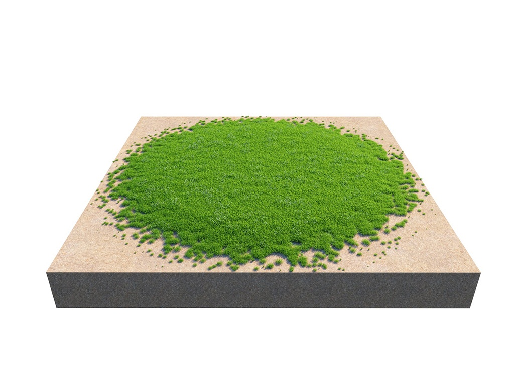

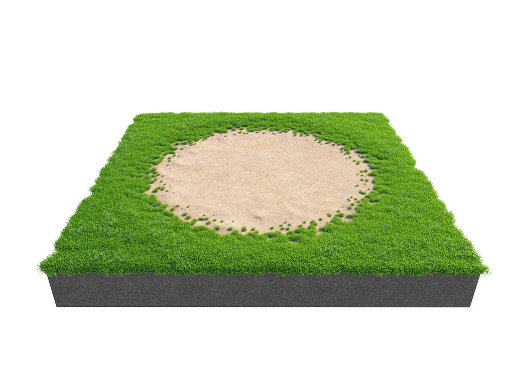

Example: Falloff
This example shows what falloff ranges look like.

Operation: Include; Falloff Near = 0; Falloff Far = 0
Operation: Include; Falloff Near = 30; Falloff Far = 30
Operation: Include; Falloff Near = 60; Falloff Far = 0
Operation: Include; Falloff Near = 15; Falloff Far = 15
Operation: Include; Falloff Near = 15; Falloff Far = 60
