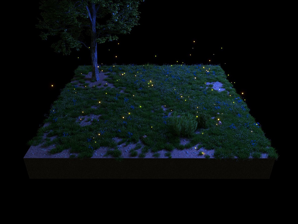

Examples: Instances Count and Per Cubic Volume
This example shows the bounding box guest objects distribution by Instances Count and Per Cubic Volume.
01_Scatter_BBoxScattering_InstancesCount_40
Instances Count = 40
04_Scatter_BBoxScattering_InstancesCount_5000
Instances Count = 5000
01_Scatter_BBoxScattering_InstancesCount_1000_PCV_125
Instances Count = 1000; Per Cubic Volume = 125
02_Scatter_BBoxScattering_InstancesCount_1000_PCV_250
Instances Count = 1000; Per Cubic Volume = 250
04_Scatter_BBoxScattering_InstancesCount_1_PCV_10
Instances Count = 1; Per Cubic Volume = 10
05_Scatter_BBoxScattering_InstancesCount_1_PCV_20
Instances Count = 1; Per Cubic Volume = 20
