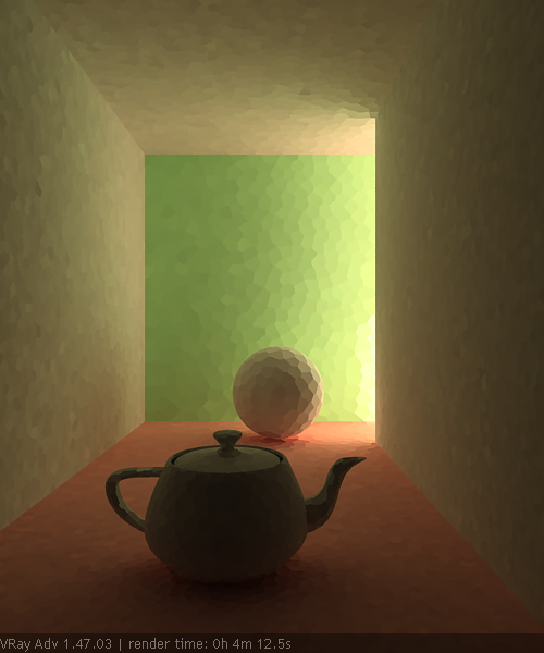

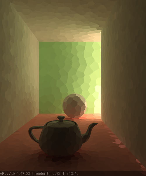

Example: The Sample Size Parameter
The Sample size parameter controls the size of the individual light cache samples. Smaller values produce a more detailed lighting solution, but are noisier and take more RAM. Larger values produce less detail, but take less RAM and may be faster to calculate.
Here is a scene rendered with different values for the Sample size parameter. All other values are the same. Note the light leak from the wall on the right in the last image - this is because samples from the other side of the wall are quite large (because of the Screen Scale) and end up being used on the side facing the camera (compare this with the World Scale in the above example). Note the difference in the noise level between the samples as well.
Sample size = 0.01
Sample size = 0.02
Sample size = 0.0
