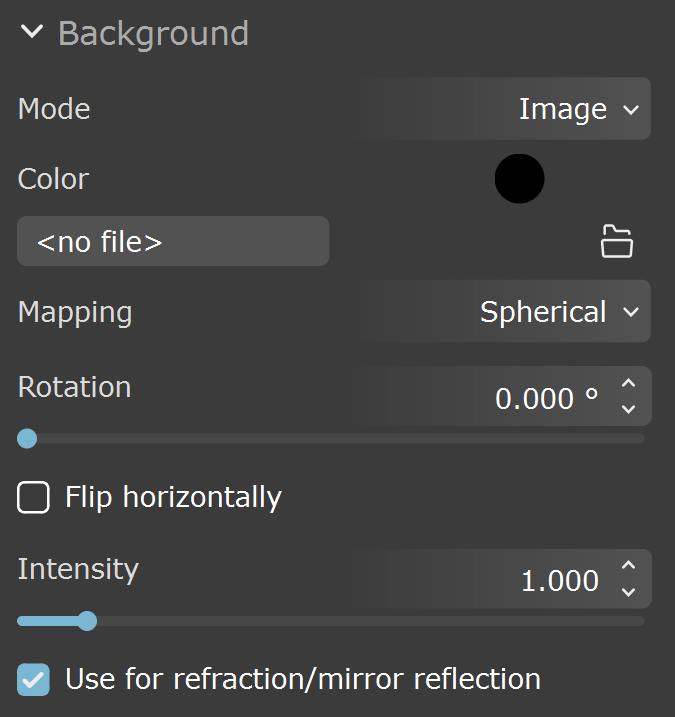

Texture Mode parameters:
Load environment – Loads an image for Environment.
Flip horizontally – Flips the environment image horizontally.
Clamp to 1 – Clamps the colors of the Environment texture to a value of 1.
Rotation – Specifies a rotation angle in degrees for the Environment texture.
Intensity – Specifies the intensity of the Environment lighting.

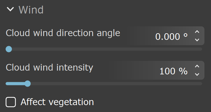

Wind
Cloud wind direction angle – Specifies the direction from which the wind originates.
Cloud wind intensity – Specifies the wind strength.
Affect vegetation – If the scene includes compatible assets like animated trees, they swing with the wind. It is recommended to use this with the DLSS or Vantage denoiser in interactive mode.
Vegetation wind intensity – Specifies the wind strength for animated vegetation.
The Cloud wind direction angle and Cloud wind intensity are available only when the Sky mode is set to Physical and the Enable clouds is on.

Background
Mode – Specifies the mode which will be used for the background. Note that the Background texture is not used for lighting and glossy reflections.
Same as environment – Uses the specified Environment source.
Solid color – Uses a solid color for the background.
Image – Uses an image as a background.
Same as environment mode
Solid Color Mode parameters:
Color – Specifies a color as a background.
Intensity – Specifies the intensity for the background image/color.
Use for refraction/mirror reflection – When enabled, the background override is used for both refraction and perfect (glossiness=1) reflection rays.
Solid color mode
Image Mode parameters:
Color – Specifies a color as a background when Background Image is empty. When a background image is loaded through the Load background option, the color has no effect.
Load background – Specifies an image to use as a background.
Mapping – Specifies the mapping method for the image - spherical or screen.
Rotation – Specifies a rotation angle in degrees for the background image.
Flip horizontally – Reverses the image along the vertical axis, swapping the left and right sides. The vertical position remains unchanged. In short, the image is flipped horizontally.
Image mode
