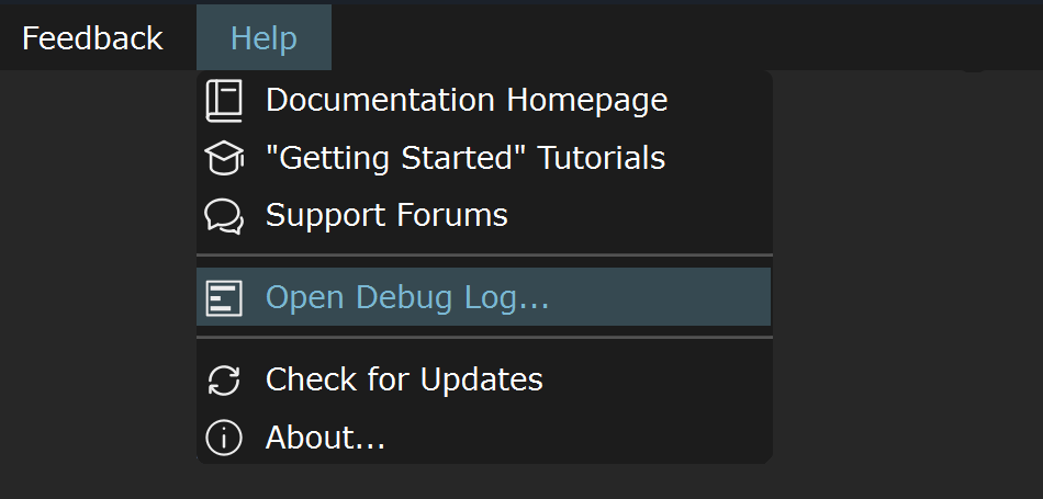

||Help|| > Open Debug Log
Vantage_OpenDebugLogMenu

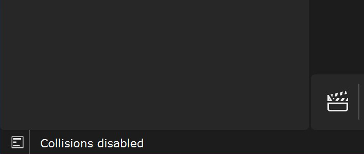

||Status bar|| > Vantage_BottomToobar_Log
 Vantage_OpenDebugLogButton

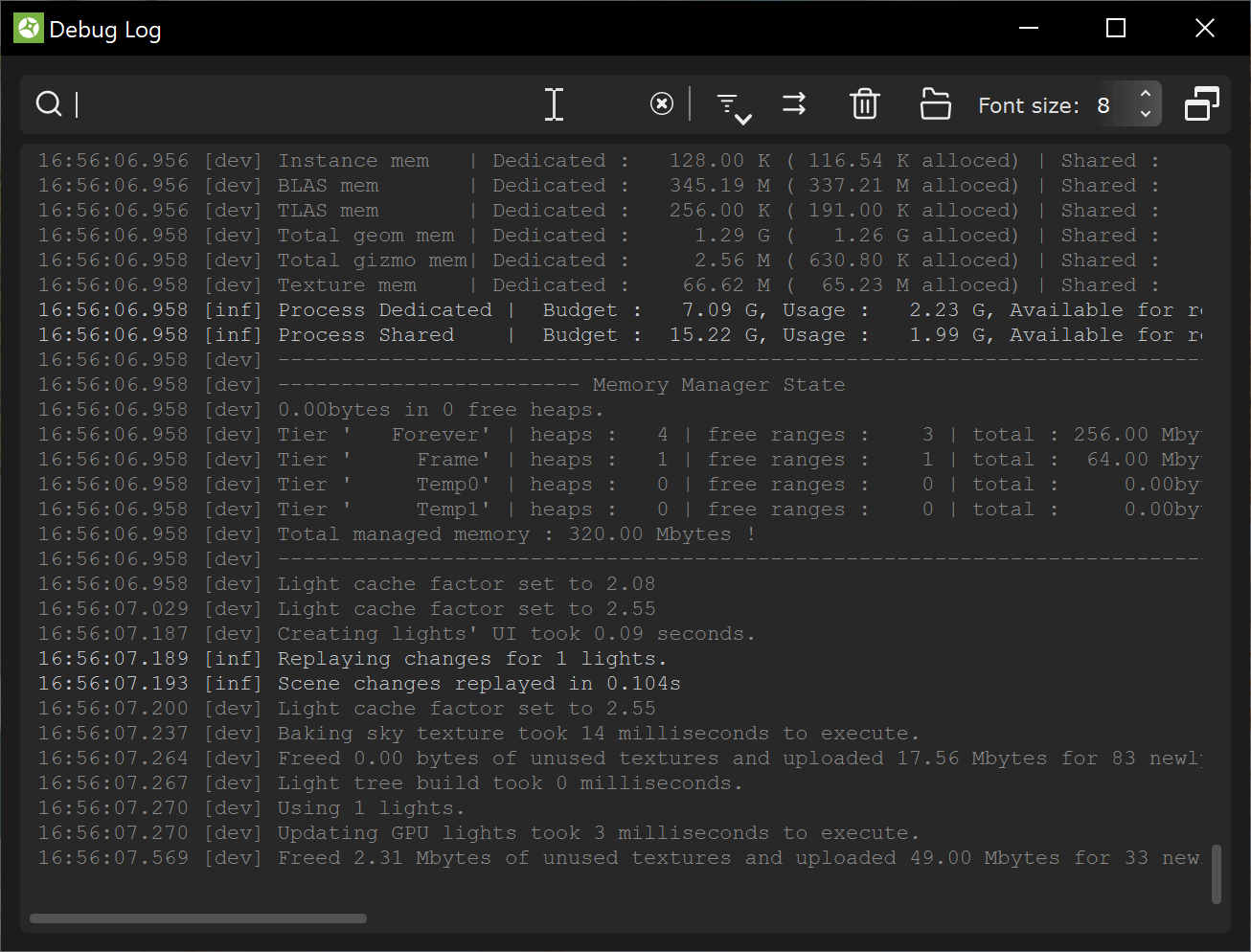

Debug Log
You can see all messages and events in the Debug log. You can apply a filter string to display only the relevant messages.
