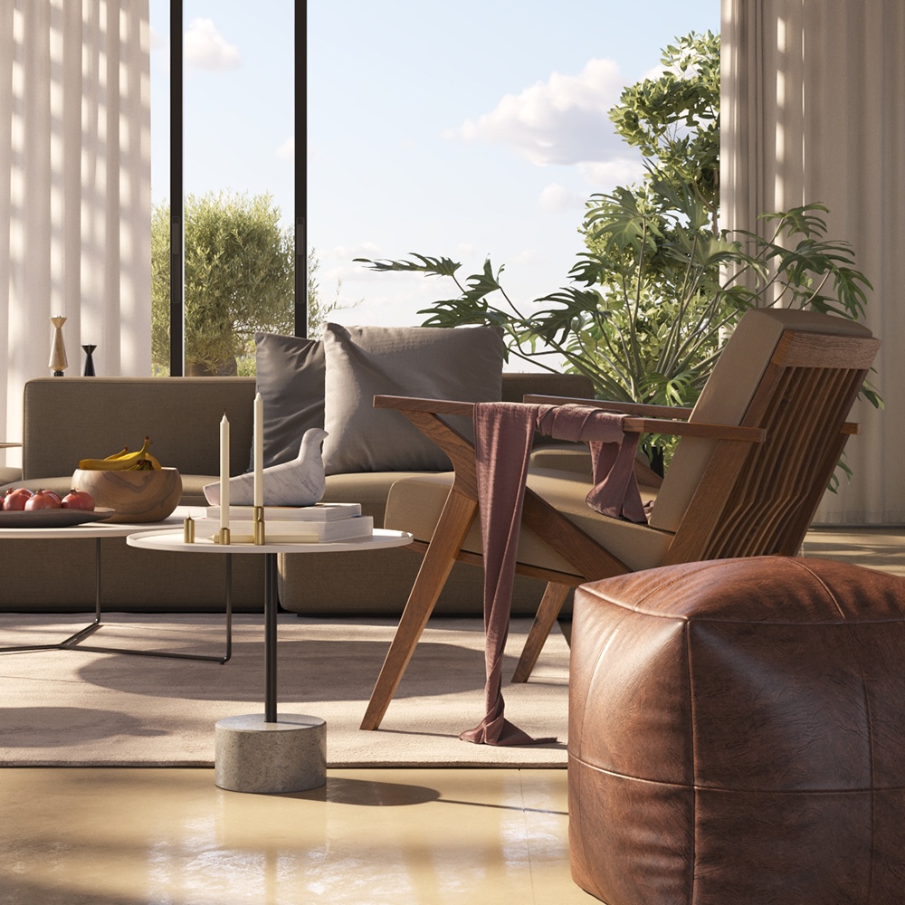

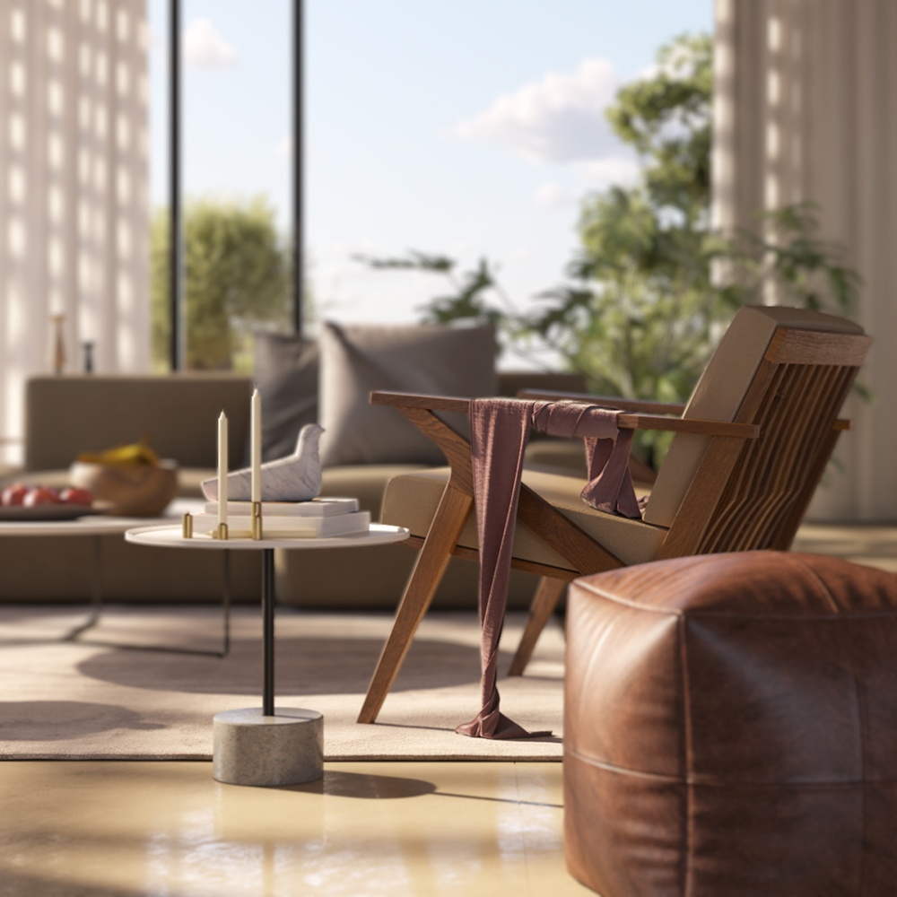

The Z-Depth render channel is useful for adding Depth of Field to the final image in post-production using a compositing application without the need for re-rendering. It can also be used to create basic fog by overlaying it on the composite with Add mode or Screen mode, with color correction as needed.
Depth of field applied to composite using Z-Depth Render Channel
Original Beauty Composite
