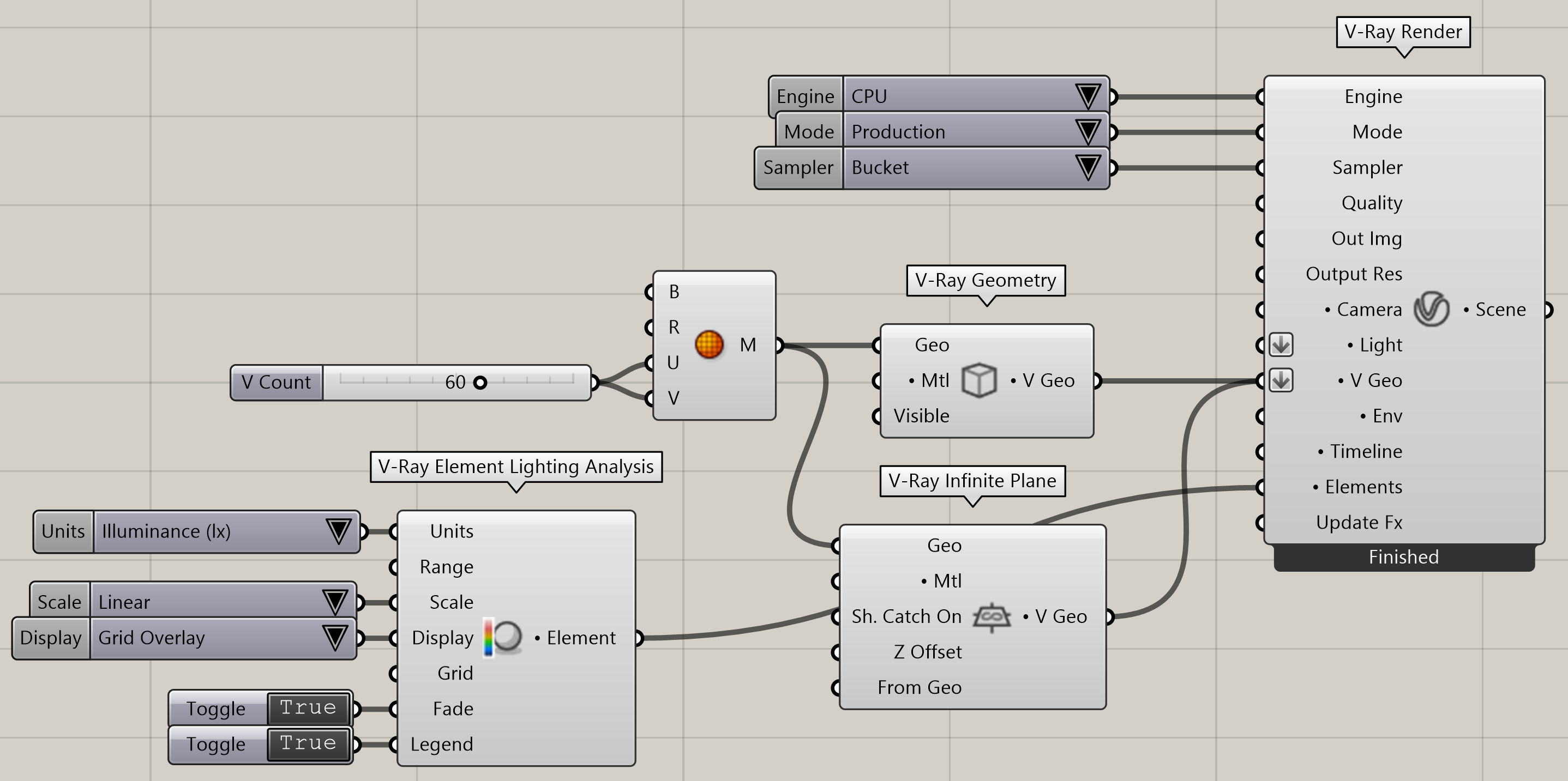

Example
Example scenario of how to use the Lighting Analysis element.
