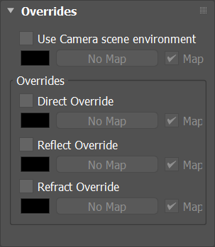

Overrides
Use Camera scene environment – Controls the override of the global illumination from the camera. When Enabled, the color/map below this control will be used as override. When Disabled, the override will be disabled.
Use Camera scene environment override is available starting from Corona 12.
Direct Override – Controls override of the environment map visible directly from the camera.
Reflect Override – Controls override of the environment map visible in reflections.
Refract Override – Controls override of the environment map visible in refractions.
