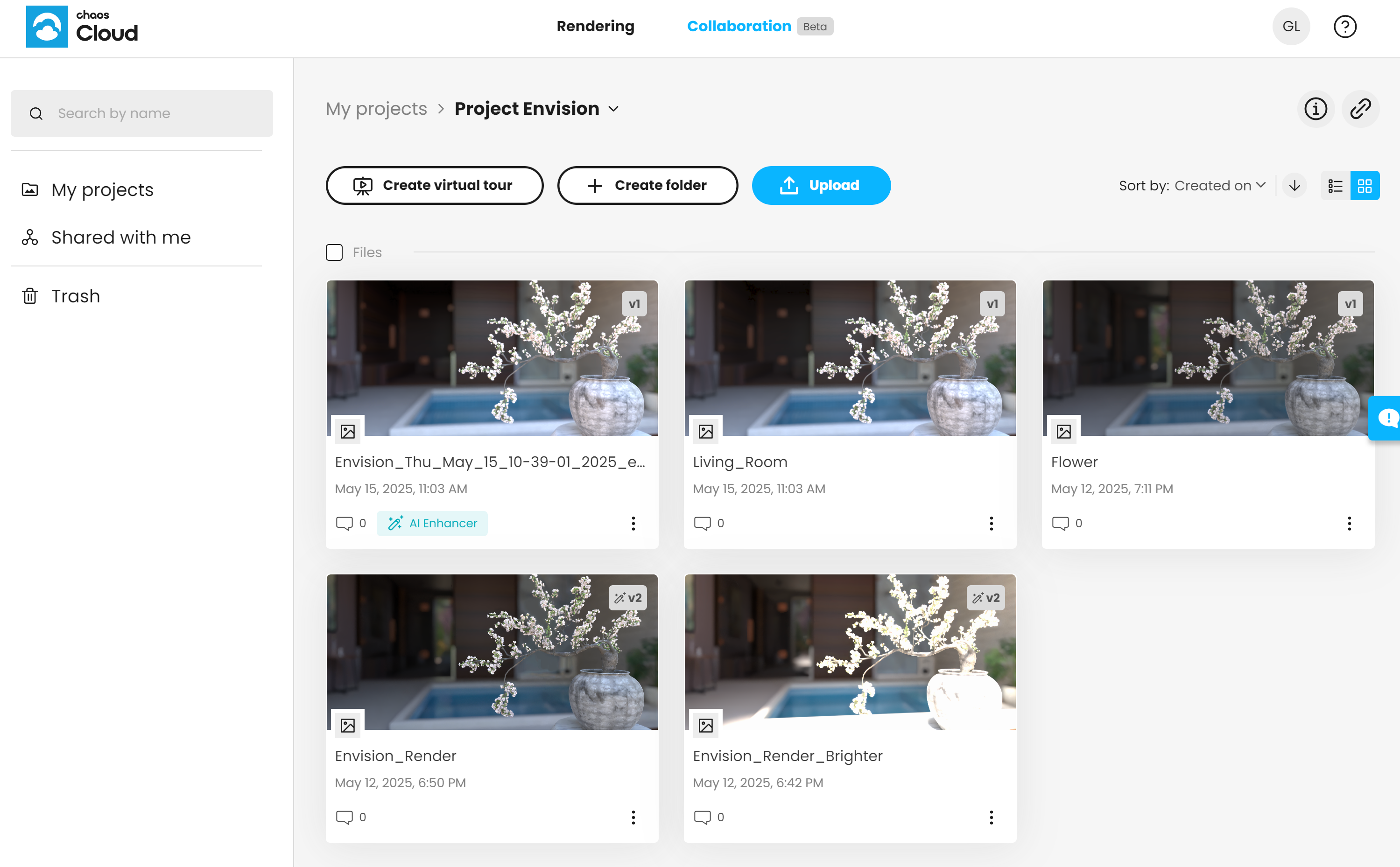

The Chaos Cloud Collaboration is a tool for sharing your work with other users. You can upload images from the Render Setup window to the Chaos Cloud Collaboration, where other users can add comments and annotations.

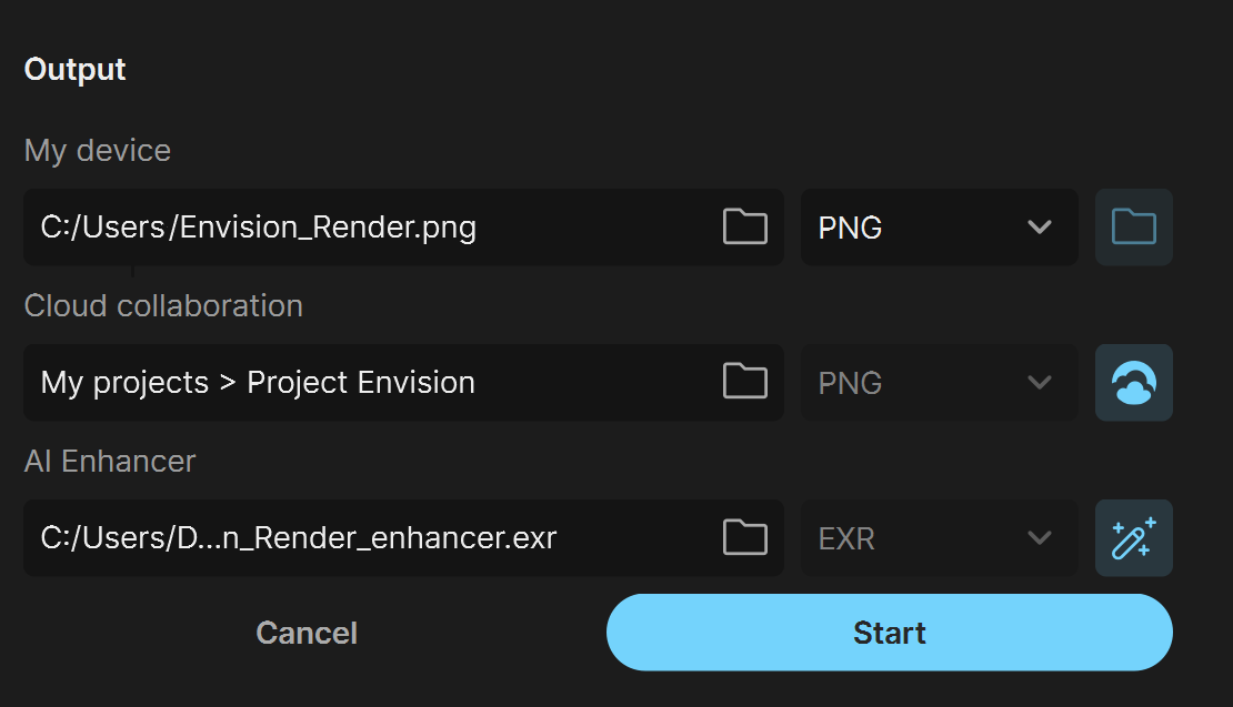

  • In the Output section at the bottom of the window, navigate to Cloud collaboration and click Choose file destination.

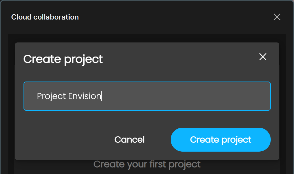

    If you are using Cloud Collaboration for the first time, you will be prompted to create a new project and upload your work there. If you've already used Cloud Collaboration with other Chaos products, you will be prompted to select an existing project or create a new one.
  • Click Create new project and type the name of your project.
  • When ready, click Create project. This creates a folder on the Cloud Collaboration website.
  • Click Select destination.
    You can create subfolders for your project and select any of them as a file destination. To do it, use the Create new button next to the project's name, and then select Create folder.
You can delete projects and their subfolders only from the Cloud Collaboration website.
  • Back in the Render Setup under the Output section, enable the Cloud () button next to the file destination field. Thus, the output is automatically uploaded after rendering.
The file format dropdown is disabled for Cloud Collaboration. The Cloud Collaboration automatically detects the render output format and uses it.
