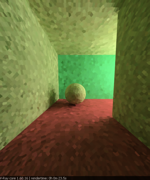

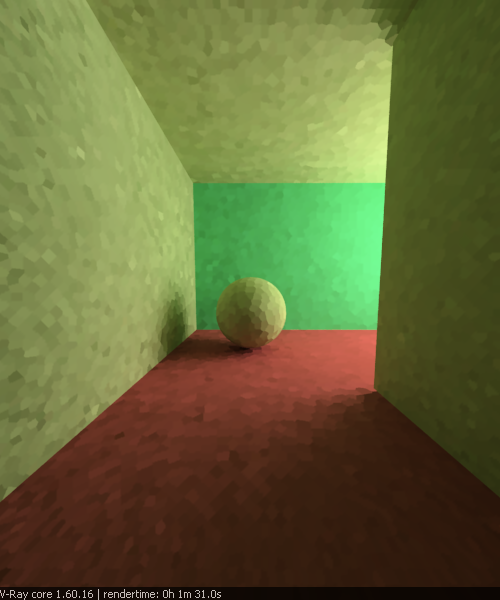

Example: The Subdivs Parameter
The Subdivs parameter controls the number of rays that are shot into the scene, and the "noise" quality of the light cache samples.
Here is a scene rendered with different settings for the Subdivs parameter, all other settings are the same.
As we add more samples, the noise is reduced, but the render times increase.
Subdivs = 500
Subdivs = 1000
Subdivs = 2000

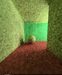

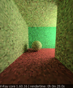

Example: The Sample Size Parameter
The Sample size parameter controls the size of the individual light cache samples. Smaller values produce a more detailed lighting solution, but are noisier and take more RAM. Larger values produce less detail, but take less RAM and may be faster to calculate.
Here is a scene rendered with different values for the Sample size parameter. All other values are the same.
Note the difference in the noise level between the samples.
Sample size = 0.01
Sample size = 0.02
Sample size = 0.04
0.01
0.04
