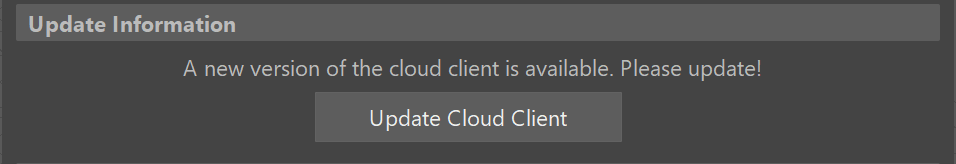

We recommend updating the Cloud App to 1.15.2. An update button is available inside Maya’s interface.
