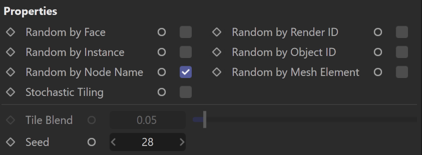

Random by Face – Considers the face IDs of the object when feeding the data (color or texture) to the material.
Random by Instance – Assigns random colors based on InstanceID (works for Alembic instances and VRayInstancer source objects).
Random by Node Name – Considers the node name when feeding the data to the material.
Stochastic Tiling – Changes the mapping based on the UV tile.
Random by Render ID – Assigns random colors based on RenderIDs.
Random by Object ID – Considers the Object IDs of the object when feeding the data (color or texture) to the material.
Random by Mesh Element –  Assigns random colors based on element (e.g. teapot lid, etc.) IDs of the object.
Tile Blend – Edge blending between adjacent tiles when Stochastic Tiling is used.
Seed – Changes the randomization pattern.

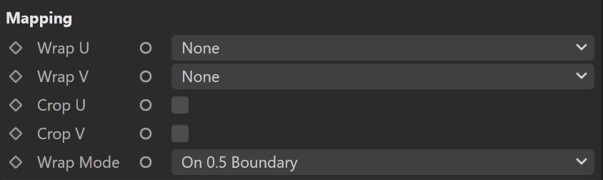

Mapping
Wrap U/V – Controls how the map is wrapped.
None – It is rendered as is.
Tile – Tiles the bitmap.
Mirror TileTiles the bitmap in a mirror pattern.
Crop U/V – When enabled, crops the map on respective axis.
Wrap Mode –
