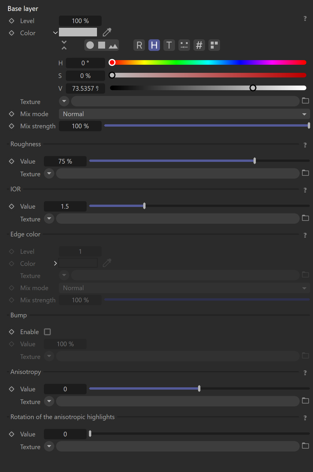

Base Layer
Level – The constant color, texture map, or shader will be multiplied by this number. Settings 50% and using pure white color is equal to using 50% gray color or using a texture map or color shader with an output level of 50%.
Color – Defines reflection color for metals (conductors) or diffuse color for non-metals (dielectrics).
Texture – Defines the texture map or shader that will be used for the material's base layer.
Mix mode – Controls the blending mode of the texture map or shader over the color.
Mix strength – Controls the intensity of the texture map or shader that is being used.
If the Mix strength is set to 100%, the texture map or shader will completely override the color unless the Mix mode is set to a different blending mode than Normal.
Roughness
Value – Controls the smoothness of the base layer surface. A value of 0% (black if a map is used) fives a completely smooth surface, which leads to sharp reflections (and possibly refractions) from the base layer. On the other hand, a value of 100% (white if a map is used) gives completely rough surfaces leading to blurred reflections. The smoothness of the surface also influences the diffuse reflections, where the smooth surface gives the perfect Lambert reflection, and the rough surface leads to a more flat-like appearance.
If the roughness mode (in the Advanced options section) is set to Glossiness, the value of this parameter is treated as glossiness.
Texture – Defines the texture map or shader that will be used for the base layer's roughness.
IOR
Value – Sets the Index of Refraction (IOR) for a non-metal (dielectric) object, which controls how much a ray is bent when entering the object and the amount of reflection in a physically plausible way. A value of 1 gives a non-bending of the ray and non-reflection, while a value of 1.52 is good for a generic glass. Precise values for the IOR of different non-metal (dielectric) materials can be found in various online references and guides.
If the IOR mode (in the Advanced options section) is set to Disney Specular, the value of this parameter is treated as a Disney Specular value.
Texture – Defines the texture map or shader that will be used for the base layer's IOR.
Edge color
Level – Specifies the intensity of the edge color.
Color – Determines metal reflection color for rays hitting the object at the grazing angle.
Texture – Defines the texture map or shader that will be used for the base layer's edge color.
Mix mode – Controls the blending mode of the texture map or shader over the edge color.
Base Color determines metal reflection for normal-incident rays.
The edge color parameters can be used only when the Metalness mode is set to Metal.
Bump
Enable – This enables the use of bump parameters.
Value – The missing coefficient between the texture and constant color. 100% means only the constant color is used, and the value in-between blend the texture with the constant color.
Texture – Defines the texture map or shader that will be used for the base layer's bump.
Anisotropy
Value – This is the anisotropy of the glossy reflection highlights. A zero value disables anisotropy (creates a perfectly isotropic highlight). A value of -1 creates a maximally anisotropic highlight on one axis, and a value of 1 creates a maximally anisotropic highlight on the perpendicular axis. The anisotropy reference frame can be defined in the Advanced options tab.
Texture – Defines the texture map or shader that will be used for the base layer's anisotropy.
Rotation of the anisotropic highlights
Value – Rotates the direction of the anisotropic highlights. Value is provided in degrees.
Texture – Defines the texture map or shader that will be used for the base layer's anisotropic highlights rotation.

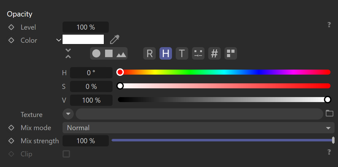

Opacity
Level –Specifies the opacity level. Both the opacity constant color and texture map are multiplied by this number. Setting 50% and using white color is equal to using 50% gray color or using a texture map with output level of 50%.
Color – Specifies the opacity of the material. It can be set as a constant color or mapped by a texture map.
Texture – Defines the texture map or shader that will be used for the opacity.
Mix mode – Controls the blending mode of the texture map or shader over the opacity color.
Clip – When enabled, this applies a threshold to the opacity map so that everything below 50% gray is completely opaque. This can speed up rendering significantly.

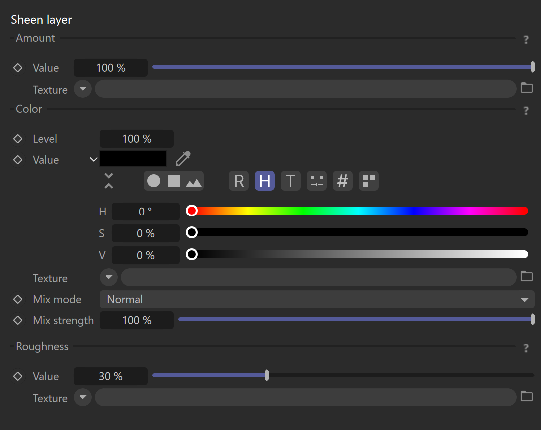

Sheen layer
Amount
Value – Sets the strength of the sheen layer. A value of 100% leads to a full sheen effect, while a value of 0% disables sheen.
Texture – Defines the texture map or shader that will be used for the sheen layer.
Color
Level – Specifies the intensity of the sheen layer's color.
Value – Sets the color of the front reflection of the sheen layer.
The sheen layer has a Fresnel factor applied to it, and thus it will have a white color when approaching grazing angles. This also means that setting the black color here does not disable the sheen effect.
Texture – Defines the texture map or shader that will be used for the sheen layer's color.
Mix mode – Controls the blending mode of the texture map or shader over the sheen layer's color.
Roughness
Value – Sets the roughness of the sheen surface. Low roughness keeps the specular highlight at the grazing angles, and as it increases, the sheen reflection dominates.
Texture – Defines the texture map or shader that will be used for the sheen layer's roughness.

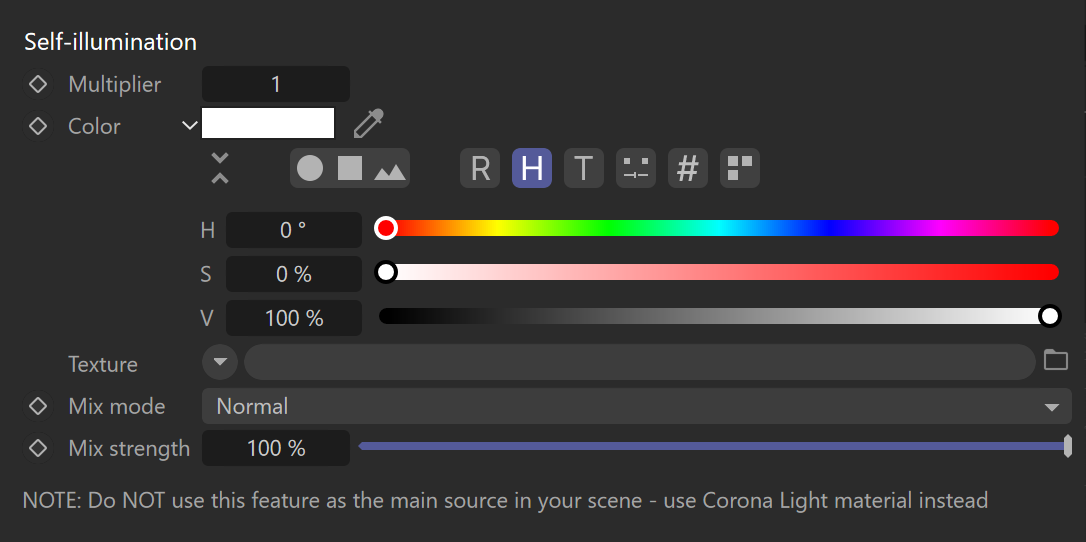

Self-illumination
Multiplier – Controls the emission property of the material. Useful to create emissive surfaces like LED text, cellphone displays, etc.
It is better not to use the Self-illumination channel as the main light source in a scene. Use a Corona Light material instead.
Color – Specifies the emissive color of the material. It can be set as a constant color or mapped by a texture map.
Texture – Defines the texture map or shader that will be used for self-illumination.
Mix mode – Controls the blending mode of the texture map or shader over the self-illumination color.

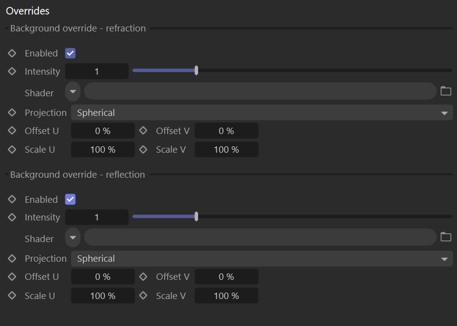

Overrides
Background override - refraction
Allows to specify a custom environment shader that is visible only in refraction on this material.
Enabled – Enables the refraction override for this material.
Intensity – Sets the intensity (also considered as the visibility) for the refraction override.
Shader – Sets the shader that is being used to override refraction for this material.
Projection – Sets the projection mode for the defined shader.
Offset U – Sets the offset in the U coordinate for the shader texture.
Offset V – Sets the offset in the V coordinate for the shader texture.
Scale U – Sets the scale in the U coordinate for the shader texture.
Scale V – Sets the scale in the V coordinate for the shader texture.
Background override - reflection
Allows to specify a custom environment shader that is visible only in reflection on this material.
Enabled – Enables the reflection override for this material.
Intensity – Sets the intensity (also considered as the visibility) for the reflection override.
Shader – Sets the shader that is being used to override reflection for this material.
