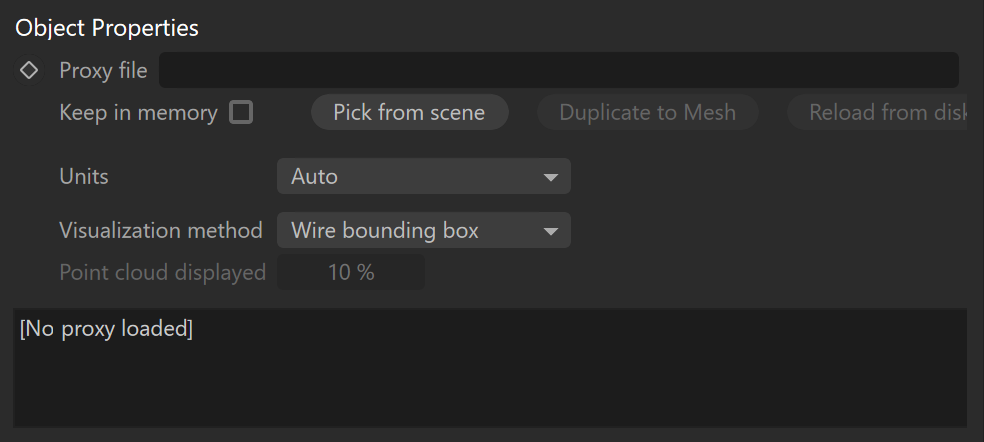

Object Properties
Proxy file – Allows the loading of a previously saved object as Corona Proxy. To load a proxy file, use the ellipsis ( ... ) button right next to the empty slot.
Keep in memory – When enabled, and the visualization method is set to Full Mesh, the model is always loaded into RAM, and this control is ignored.
Do not flush a model from RAM between renders. It increases scene parsing speed and memory consumption when enabled.
Pick from scene – Allows the creation of a new proxy from an object picked from the current scene.
Duplicate to Mesh – Clones the proxy to a regular mesh object.
Reload from disk – Reloads a previously loaded proxy file from a disk.
Units – Use this parameter to set a specific measurement unit for the proxy object. Depending on the selected unit, the object's size will be affected.
Visualization method – These options set the viewport visualization method. Available visualization methods are:

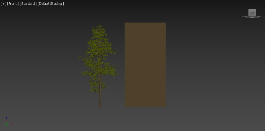

Solid bounding box – Using this option displays the proxy object as a solid box.

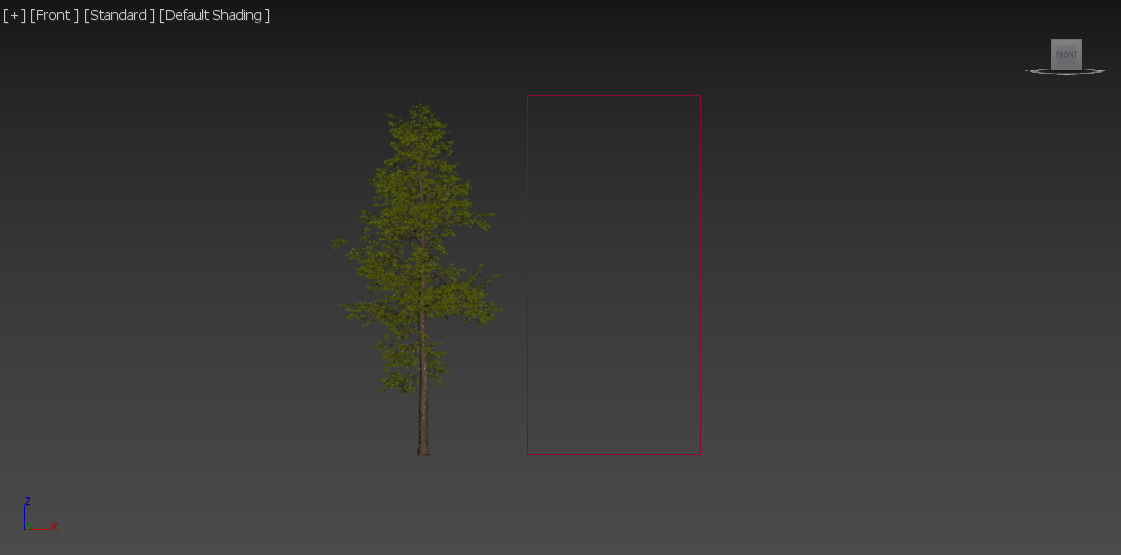

Wire bounding box – Using this option displays the proxy object as a wire box.

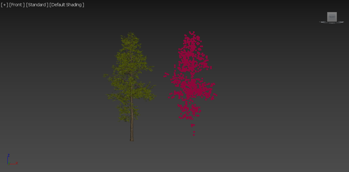

Point cloud – Using this option displays the proxy object as a cloud made out of points.
The Point Cloud visualization method is the recommended solution, as it makes it easy to see the shape of the proxy object while keeping great viewport performance.

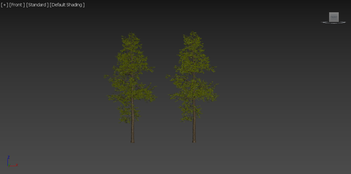

Full mesh – Using this option displays the entire geometry that the proxy object contains as if it wasn't a proxy object.
The Full Mesh option should not be used in cases involving complex geometry, as it does not bring any viewport performance improvement compared to displaying the original geometry.
Point cloud displayed – Defines the level of visibility for the Corona Proxy object in a viewport.
The Point cloud displayed parameter is only available when the Visualization method is set to Point cloud.

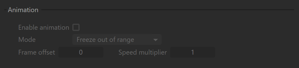

Animation
Enable animation – When enabled and if there's animation data included in the proxy file, then the object's animation will start playing.
Mode – These options allow you to select the animation playback method.
Frame offset – Offsets the animation starting point for the Corona Proxy object.
Speed multiplier – Speeds up or slows down the animation playback for the Corona Proxy object.
The animation options are only available if animation data is included in the proxy file.
