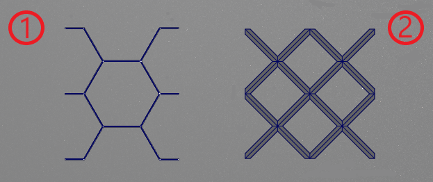

Example: Multiple Reference Geometries
This example shows how applying multiple reference objects affects the mesh. Click on the expandable field to see the original reference geometries and the order they were used in. A V-Ray Light material with varying Opacity is applied to the reference objects.
