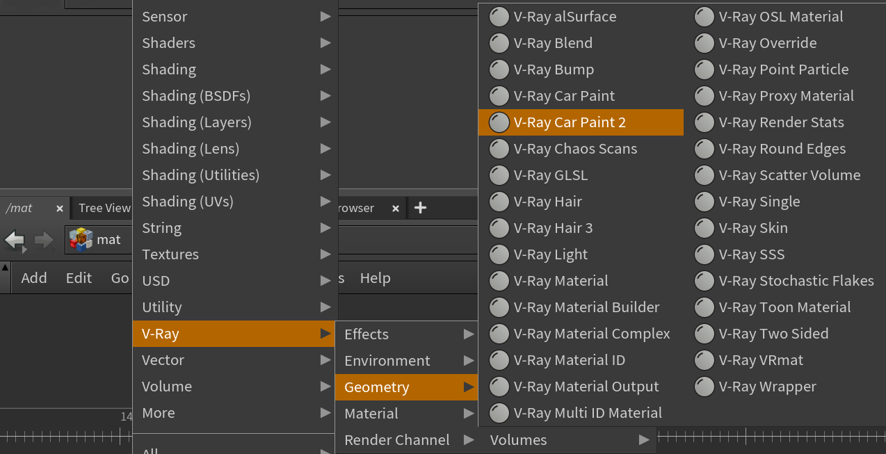

UI path: ||mat Network|| > V-Ray > Material > V-Ray Car Paint 2
