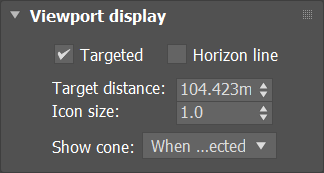

Viewport Display
Targeted – Makes the Corona Camera targeted.
Horizon line Enables/disables Horizon line.
Target distance Defines the distance from the camera to the target.
Icon Size The size of the camera origin icon in the viewport, relative to the default size (1.0).
Show cone:
Always – Always shows the camera cone.
Never – Never shows the camera cone.
When selected Shows the camera cone only when camere is seleceted.
