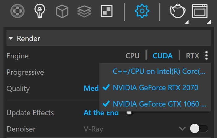

Choosing Which Devices to Use for Rendering
You may not want to use all available GPU devices for rendering, especially if you have multiple GPUs and you want to leave one of them free for working on the user interface or you may want to combine your CPU and GPU together (see the Hybrid Rendering section below).
There are two ways to do this: by using the supplied standalone device selection tool, accessible from both the V-Ray Tools menu and the Start menu search, or from the Asset Editor's GPU device dropdown list.
When selecting devices from the standalone tool, that will set the default setup for the work station. After changing this option, you need to restart SketchUp and/or any Standalone DR servers (if any are running) for the changes to take effect. If the Standalone DR server is running as a service, you may need to restart it.
The GPU Device Selection tool is not available on macOS X. |
When choosing the devices from the Asset Editor - it is done only for the current session in SketchUp.
||V-Ray Asset Editor|| > Settings > Render > GPU device list (dropdown)
SketchUp menu Extensions > V-Ray > Tools > External > GPU Device Selection
Or find the vray_gpu_device_select.exe file here C:\Program Files\Chaos Group\V-Ray\V-Ray for SketchUp\extension\vrayappsdk\bin.
If you see your CPU listed twice, choose the option with "C++/CPU " in the name. |
